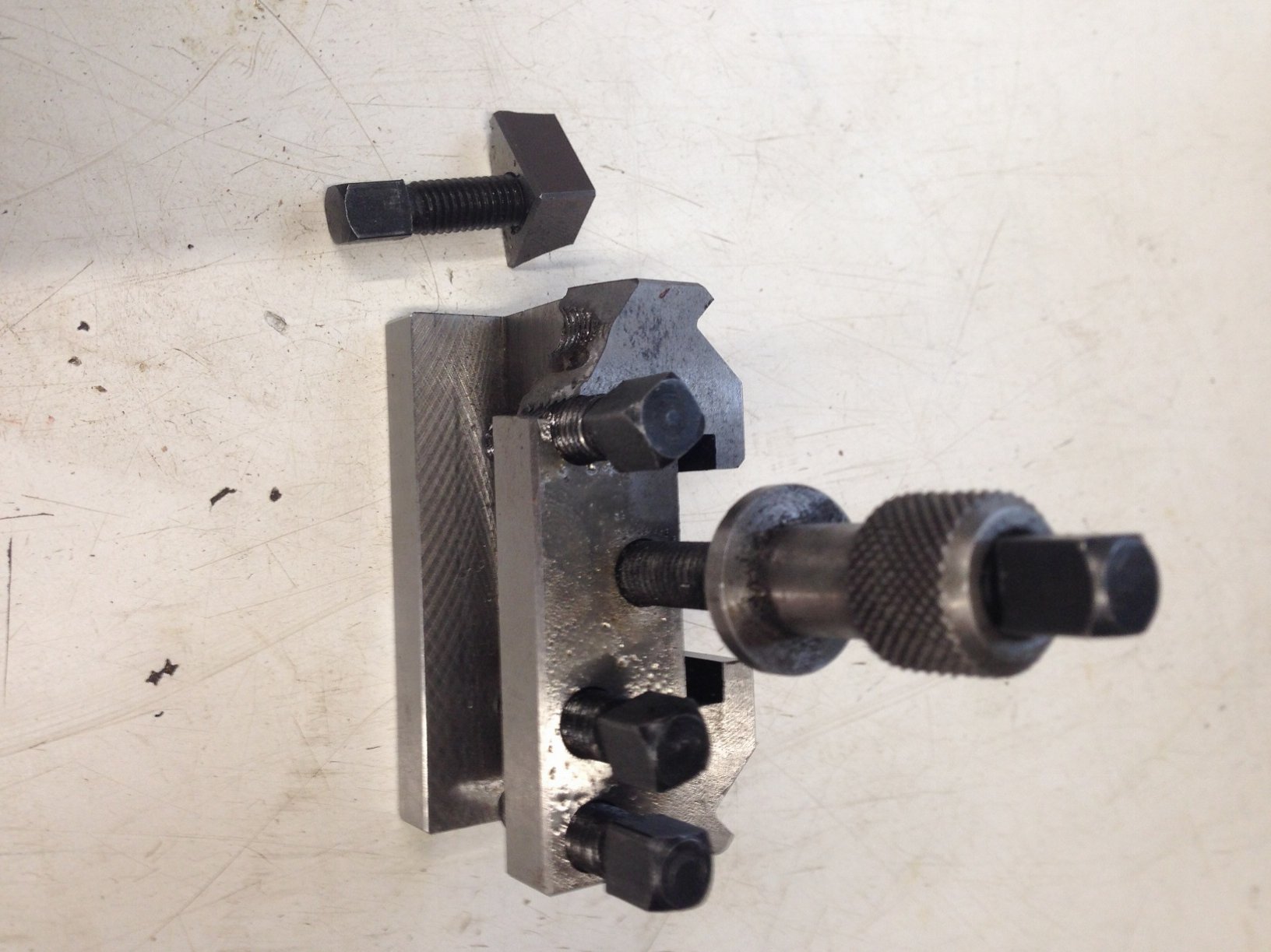

Loading a tool it to my qctp and did this I thought it was steel but no

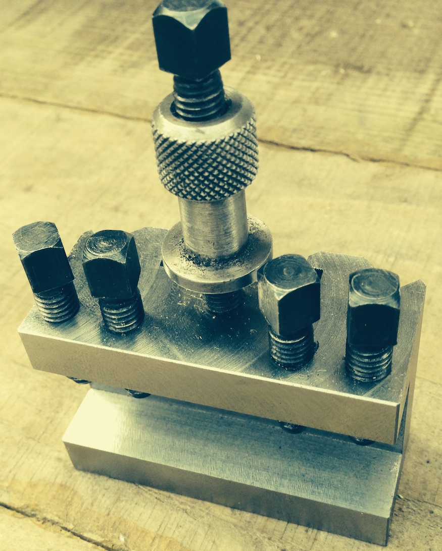

So though I would have a go at making some this might be a simple task for some folks but has made me think lol

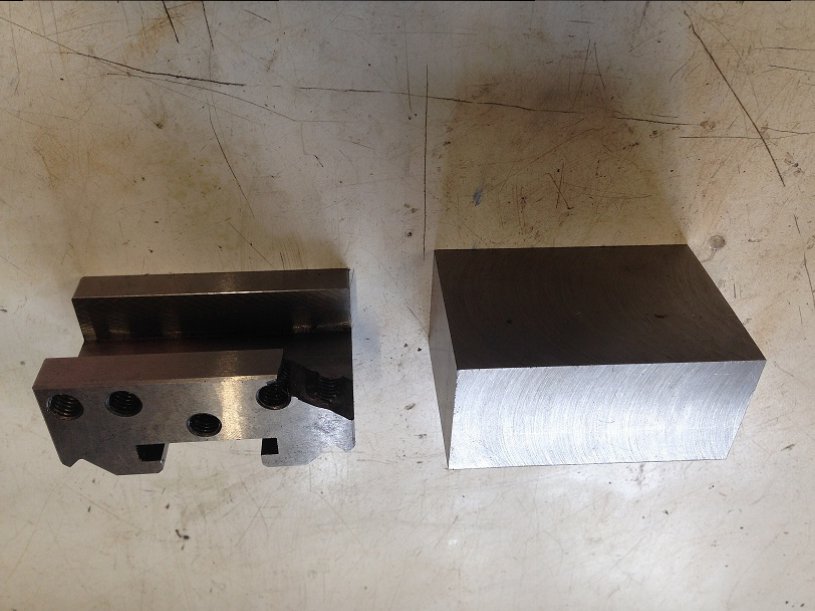

Bought a lump of steel bar from local steel stockiest cut a chunk off poped it in the mill and got to this

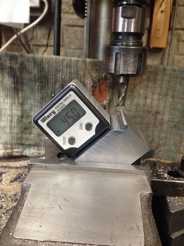

Had a measure of the angles so back in the mill for the first cuts

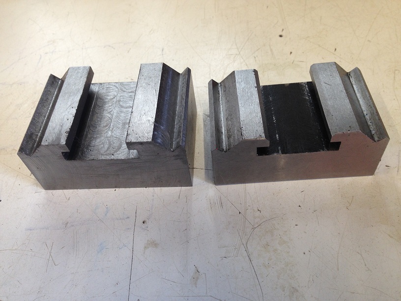

So as far as i have got is to here
not to bad just got to mill slot for tools and drill and tap holes and machine to final size
