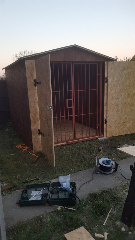

That's a great idea. Cheers.weld the plates behind the hinges on the door so when it closes the plates go behind the door frame.so even if the hinges are cut off it cant be pulled opensimlar to having pins that recess in to the frame on security doors when closed
Nah it is helpful, You've got to know it's weak points. There's enough flat bar around the walls and roof to make it noisy but yeah, a decent circular saw would do the trick. Most scrotes have power tools, I'm just hoping they've all got1.5ah batteries .I wouldn't need a grinder to get into that. I'd use a recip saw or a circular saw, and cut my own doorway.
That, or some very large crowbars....
OK so that wasn't helpful, sorryAs above - make some shrouds for the hinges.
It's not about making it invulnerable to thieves, it's about making them take as long a time as possible, with lots of noise. If they can't just lever some hinges off, then they'll have to attack with grinders, or cut a random hole in the chipboard.
