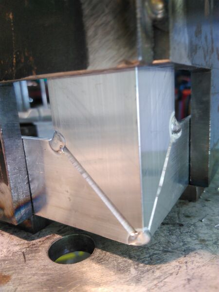

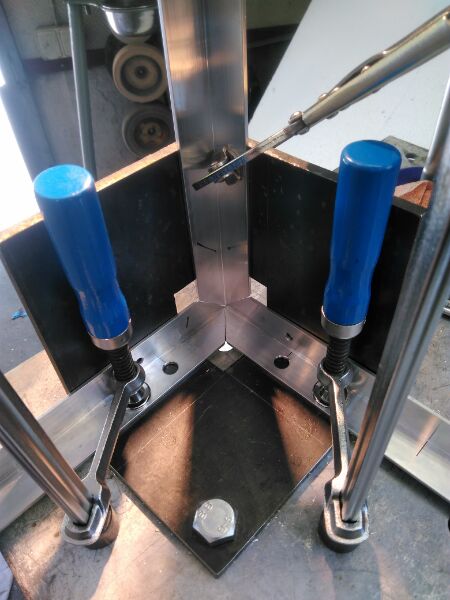

That’s a nice jig and excellent fitup there AndersThree plates with notched corners, of together and you have a 3D fixture.
Can access both outside and inside for tacking. View attachment 147654 View attachment 147655
Thx Brad, and that reminds me to show how to bevel fast on aluminium.That’s a nice jig and excellent fitup there Anders
