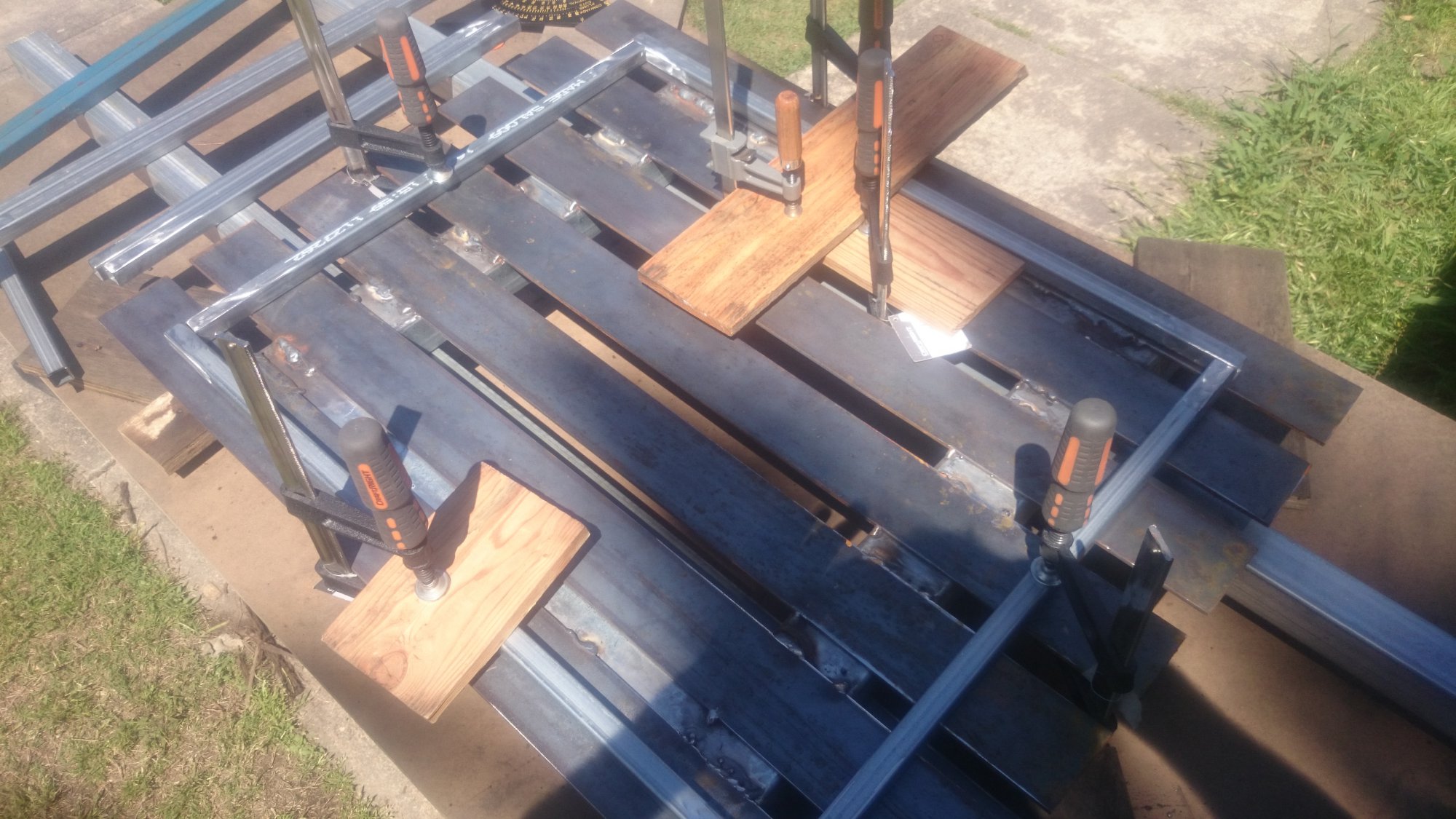

Well as much as I really really want one, but can't really afford or justify a certiflat at the moment. I built somewhat of a jig table. Really just a platform at the moment, as it doesn't have legs. It's just 5mm flat bar laid and welded across a frame of 75 by 50mm 3mm wall RHS. Flat bar is spaced 25mm apart so that I can fit F-clamps in between.
