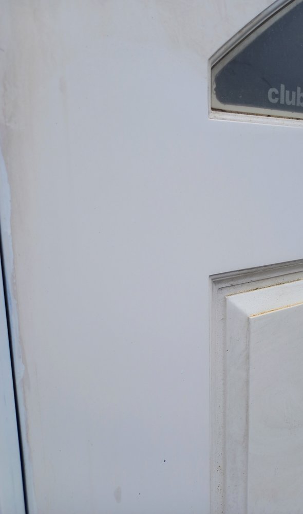

Epoxy primer followed by paint of your choosing. 2k would be best if practical otherwise a decent quality 1k acrylic, although the world is your lobster. You could even Dulux it as the epoxy will be giving the performance layer.Something I won't be doing now time of year etc but my fiberglass white garage door colour has failed.
Next year I want to paint it white again. What's the correct paint for this job?

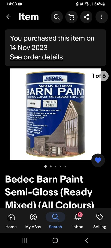

Well this is correct as I had a good read up on applications , before i brought it and basically apply without any primer.Not sure if it was clear - I was suggesting to use the Barn Paint as the only coating. 2 or 3 coats and job done.
