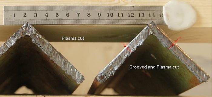

Hi,
Was trying to cut up some 6mm thick 80mm angle today (adjusting the size of a HUGE metal bench)...
Got bored with the grinder after the first cut and dragged out my cheapy plasma cutter.
Melted and set fire to the plasma tip/shroud after another 2 cuts
, so back to the grinder with a cutting disc.
Then had an idea: I cut a 1-2mm deep groove with the grinder and tried the plasma (with new bits) again... worked really well
With the plasma tip being a contact type and asking it to work hard on 6mm steel, the tip gets spattered and ends up knackered pretty quick - with a groove to cut into (which is only 2-3mm wide) it seems to prolong the life of the tip enormously and cuts quicker.
I made a further seven cuts with the groovy method and the tip's still in fine fettle
Yours,
Tony Wilk
