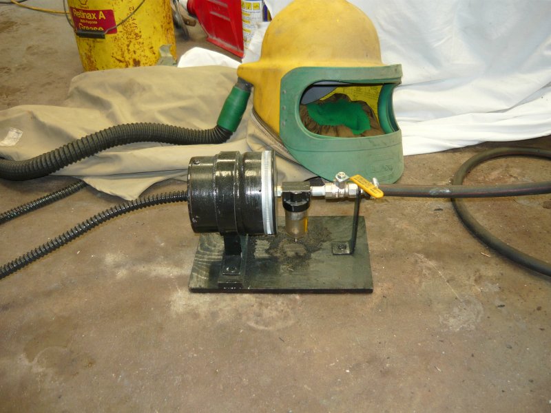

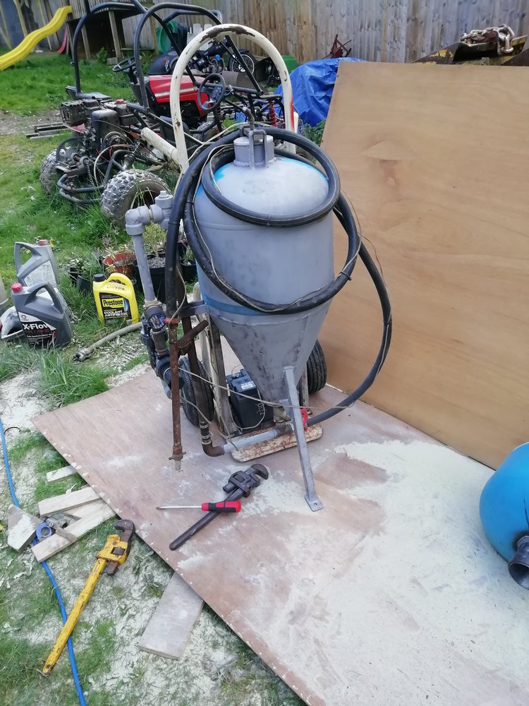

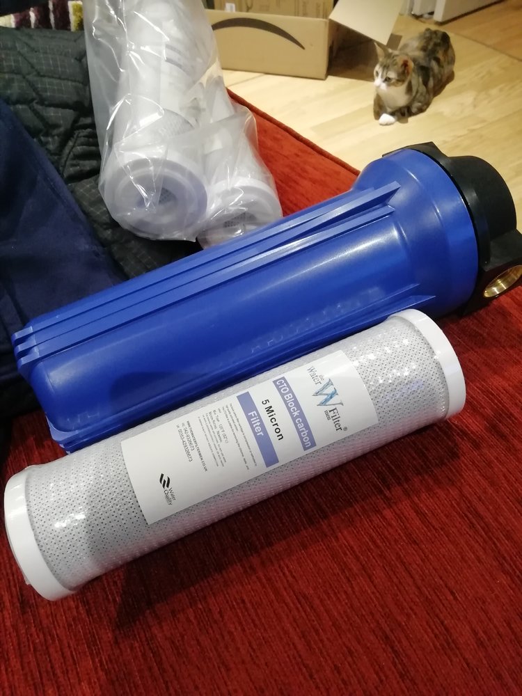

I have just been making up a filter for a pressure fed helmet For grit blasting. So my idea is air coming from the main compressor which is around 80 CFM at 100 psi first through a water trap then through a regulator regulating down to maybe 10 psi then through a 10 inch 5 micron Carbon water filter to remove any impurities and dust then through a hose to the helmet what do people think I think I have it covered any suggestions
Thanks Tom
