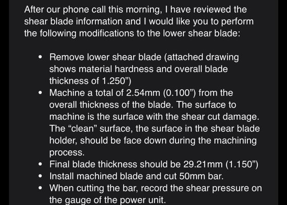

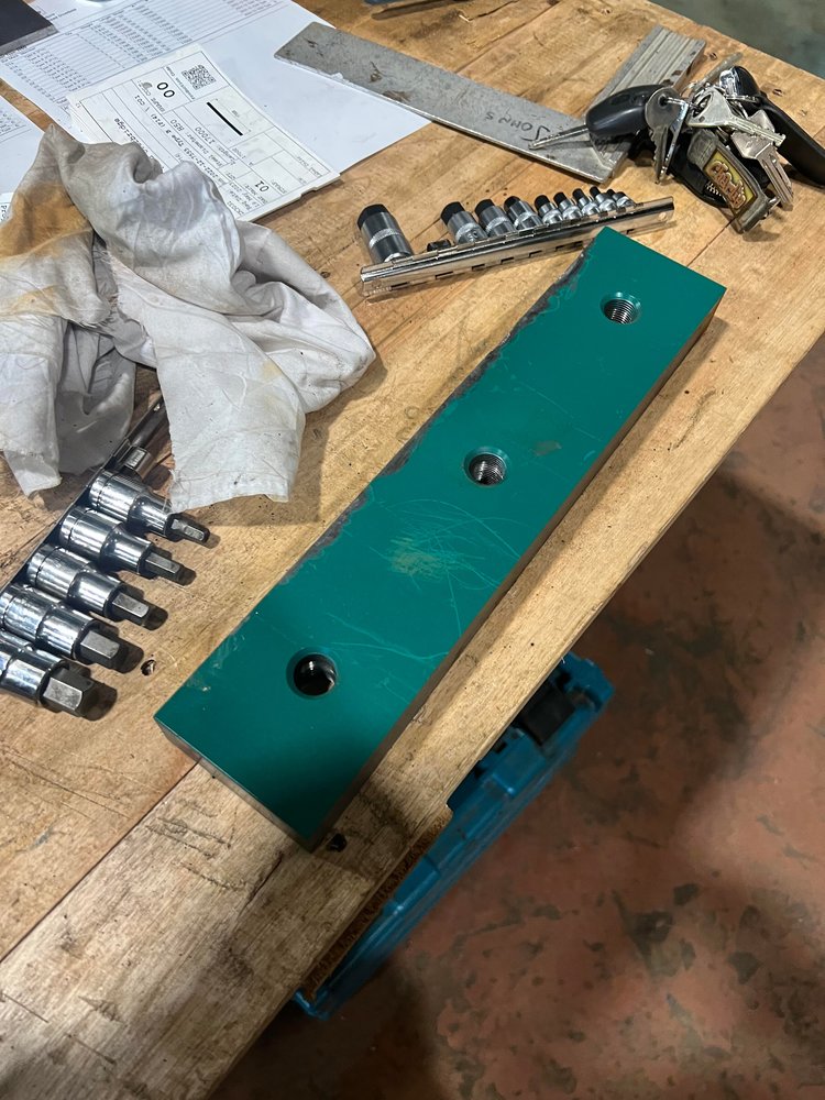

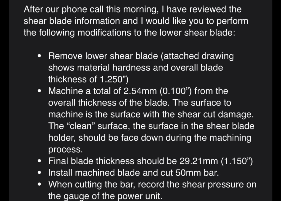

Could you note the length of it so if someone has a suface grinder they know if it will fit within its travel.
Do you know how it is hardened (surface or through)? If you take 2.54mm of one face, there is some possibility it will distort. Equal amounts off both sides will reduce this possiblity.
I will ask for dims. But this might help.Could you note the length of it so if someone has a suface grinder they know if it will fit within its travel.
So surface grinders don't remove in mm but thous? Or metric equivalent.I was wondering if it was face, edge or ends.
I would not be removing 2.5mm with a surface grinder!
