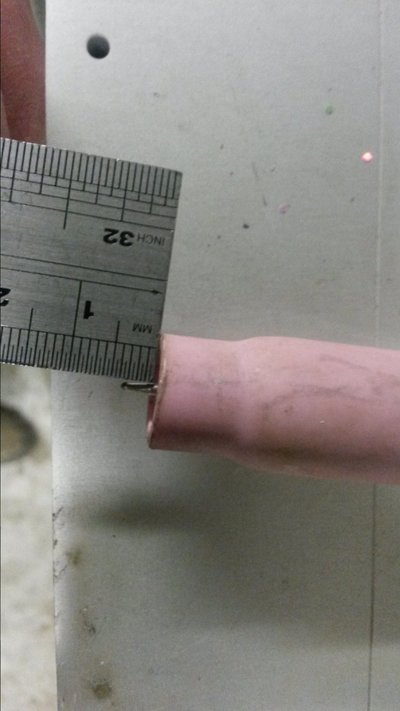

I've mostly been messing around with 2mm plate, and have had some really pleasing results - managed some really tidy looking fillet welds. However, I then realised I was welding at around 75A with a 2.4mm red tungsten, which is really too big for the amps according to the manual. So I went down to a 1.6mm and although I can weld OK sometimes, the arc seems to dance around a lot making it difficult to get a consistent pool. I can only guess there is some contamination somewhere, or that it's my grinding - I struggle with these smaller ones to get the angle level around the full diameter: would this cause the problem I'm describing? I feel like a harder wheel would help to remedy this - any tips on what sort of wheel to buy so I'm not constantly dressing out the grooves (or is this normal)? The wheel I'm using is dedicated to this job by the way.
I've also noticed that the tungstens discolour within the body of the torch where they're held by the collet - they turn black or blue. I can scotchbrite this away sometimes (along the length, not spinning it), but it's often quite hard. Is this a gas problem? I'm using 6/7lpm as advised on the setup tutorial, pure argon with a flow-meter.
