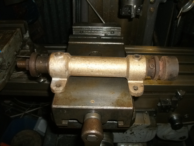

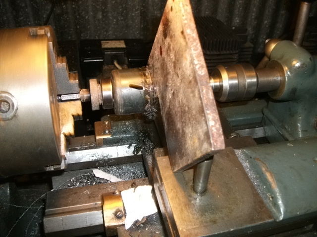

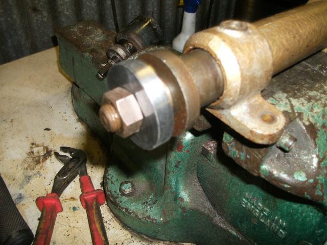

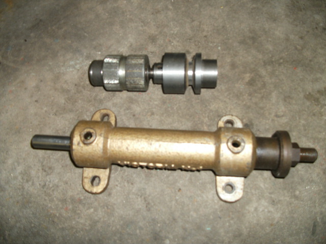

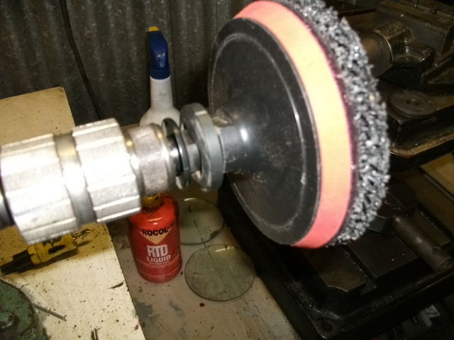

i picked up a head from the autojumble 5 quid. one of the cup washers was missing the other end had just the driving pulley. i made the cup washer out of some old plate cut out with a hole saw in the lathe running on a slow speed faced it up and bored it out . the other end i bored the pulley out to take an adaptor chuck out of an sds electric drill just have to fix the motor belt and base next
