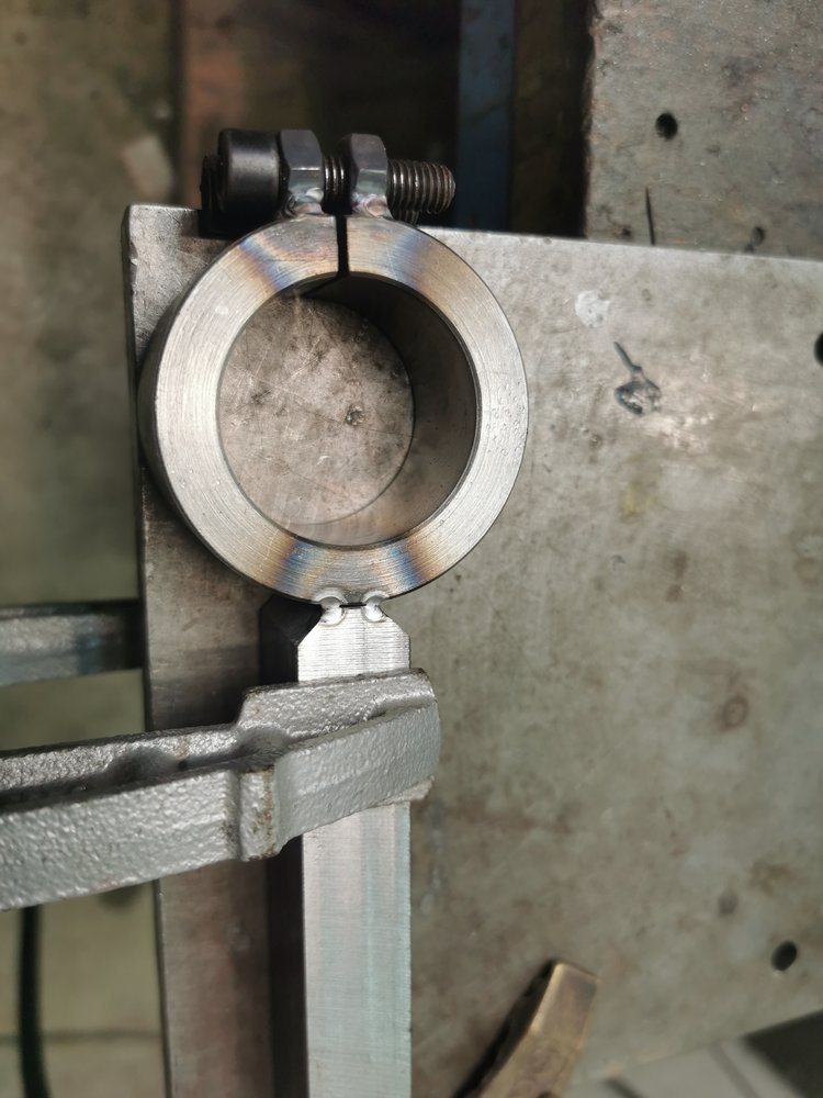

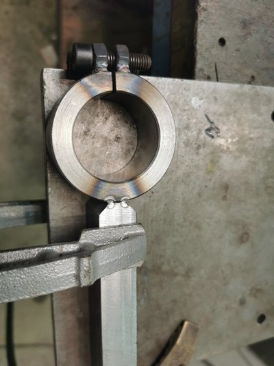

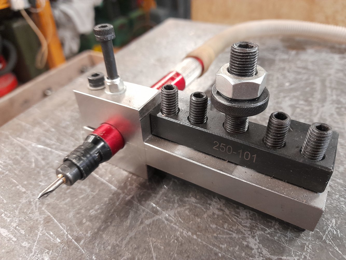

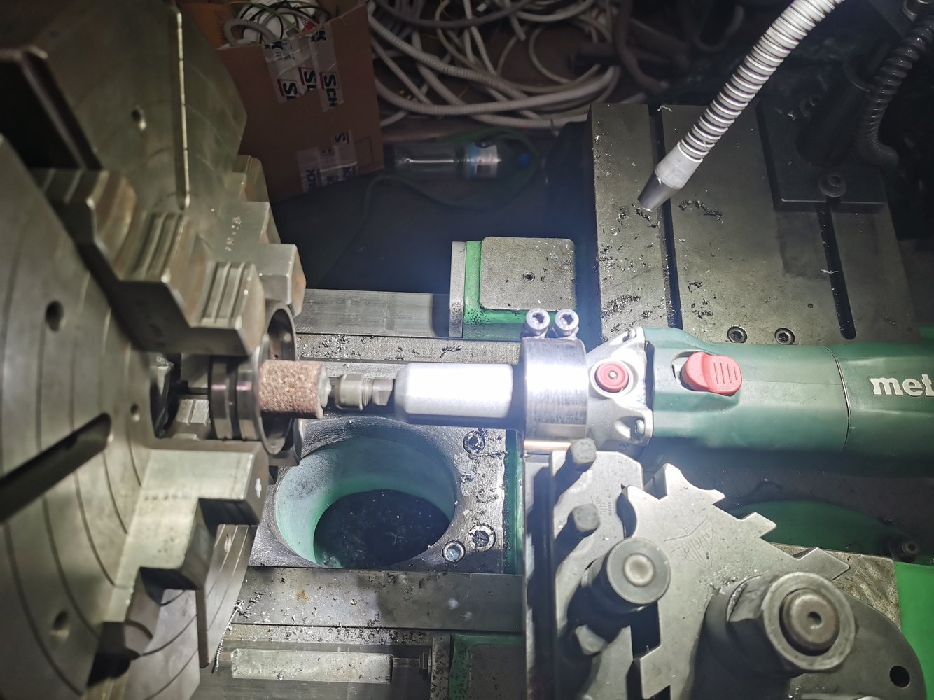

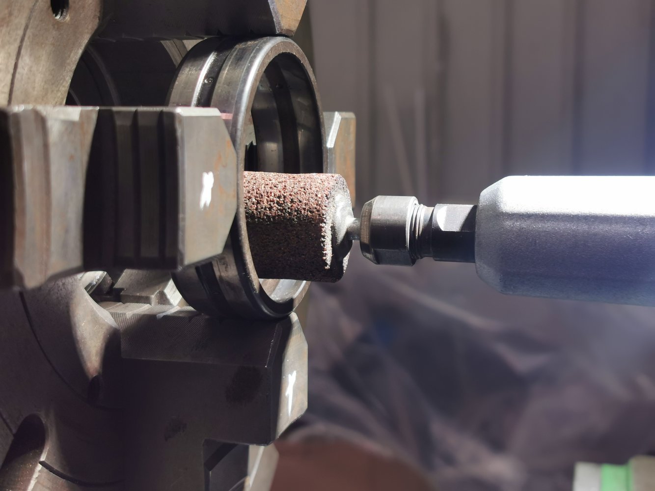

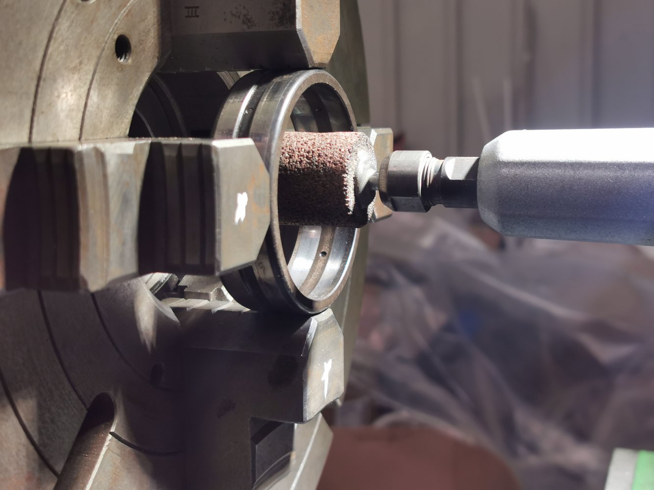

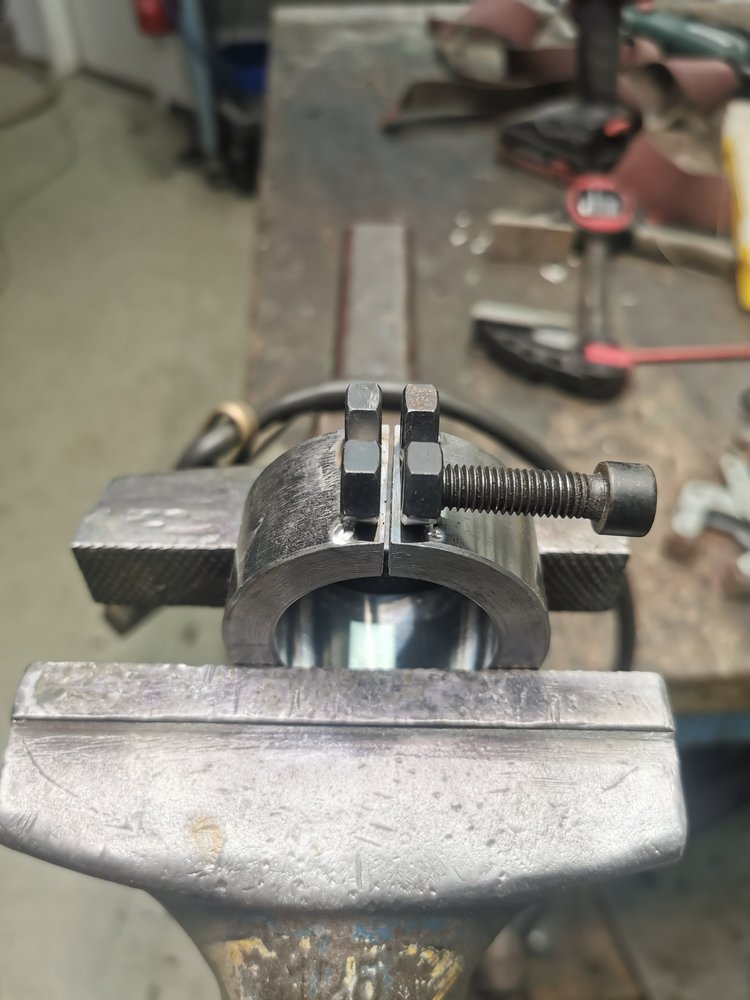

Made one exactly like this to grind the inside bearing surface of a mini 1st motion shaft, works well as long as the die grinder bearings are good. And the stone is not out of shape/balance.proof of concept.

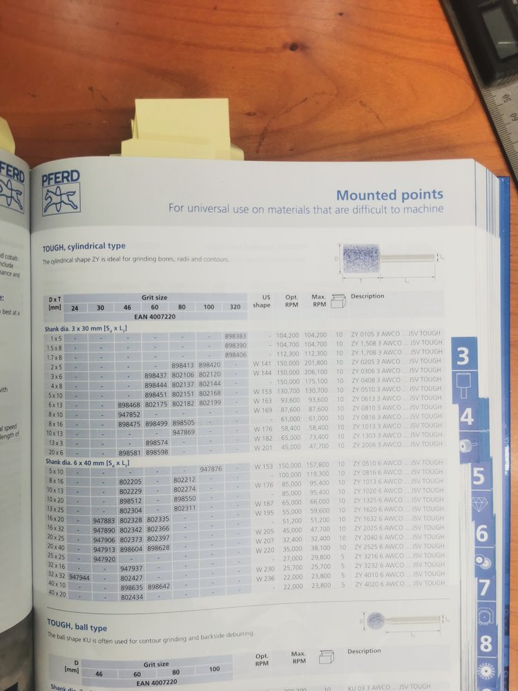

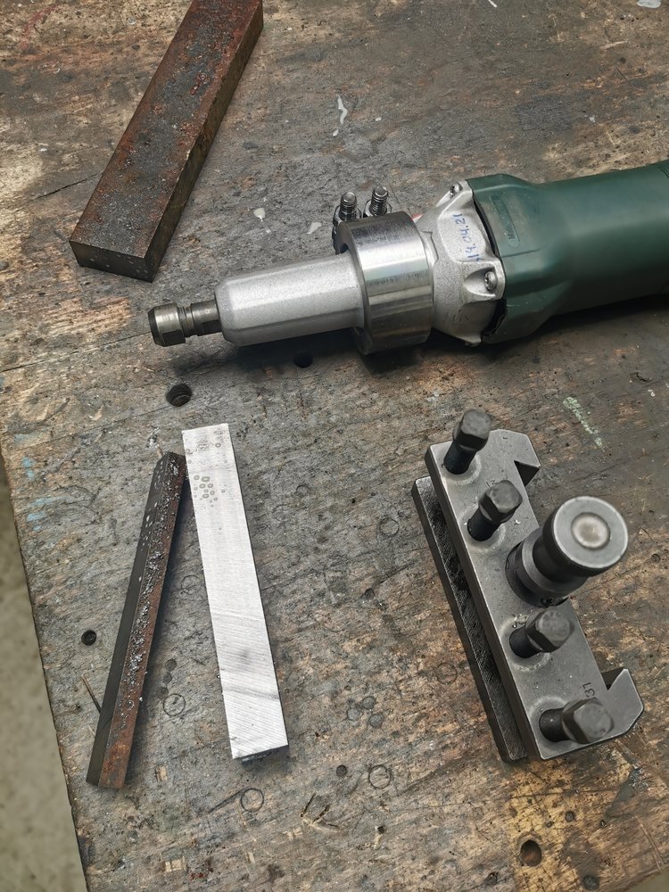

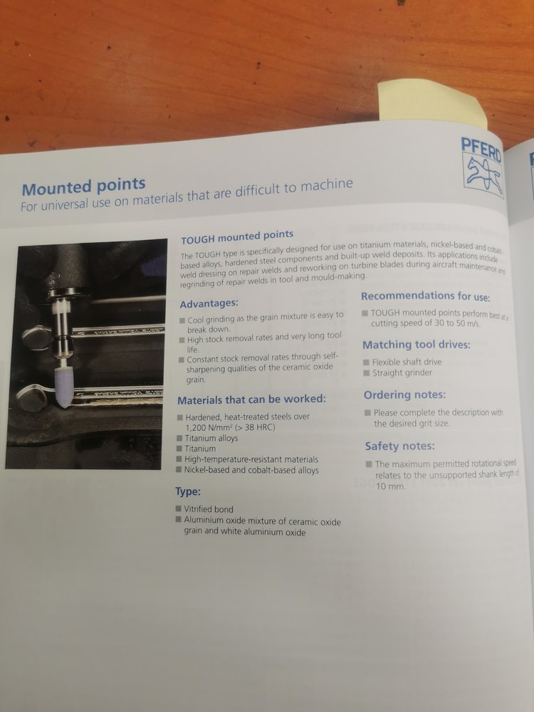

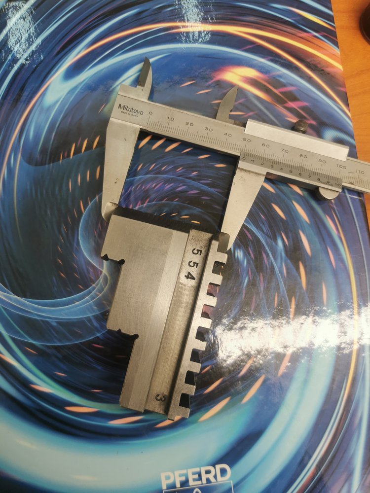

Collected from scraps. A stone for grinding the jaws of a lathe chuck, I will buy a better quality. I took a rough Chinese stone from a cheap set.

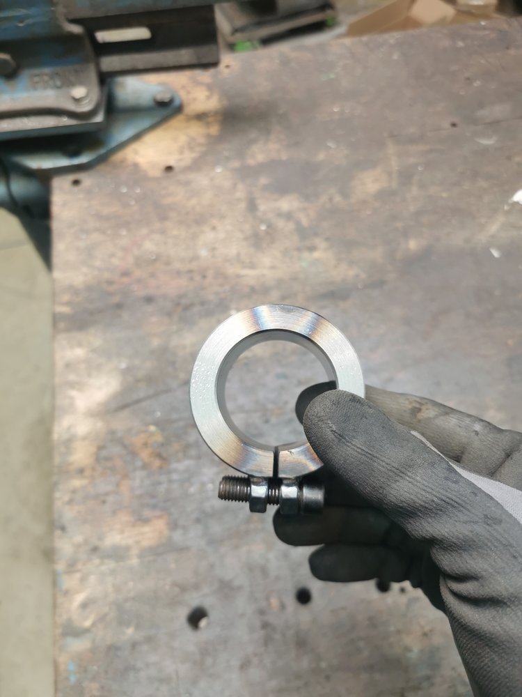

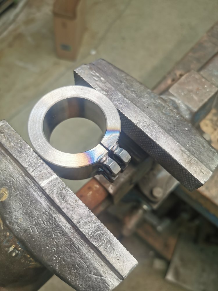

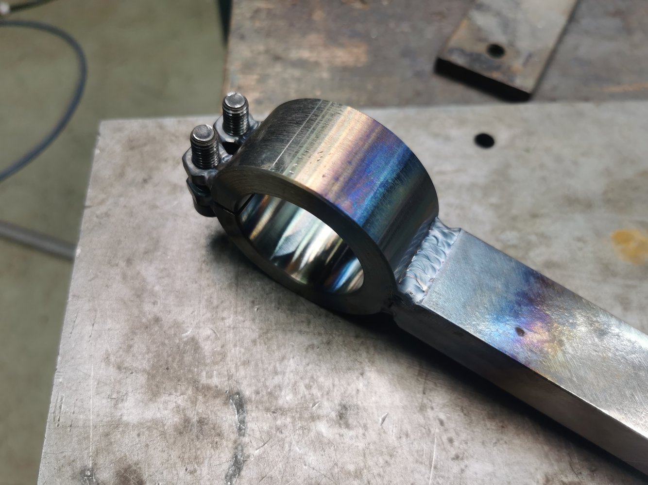

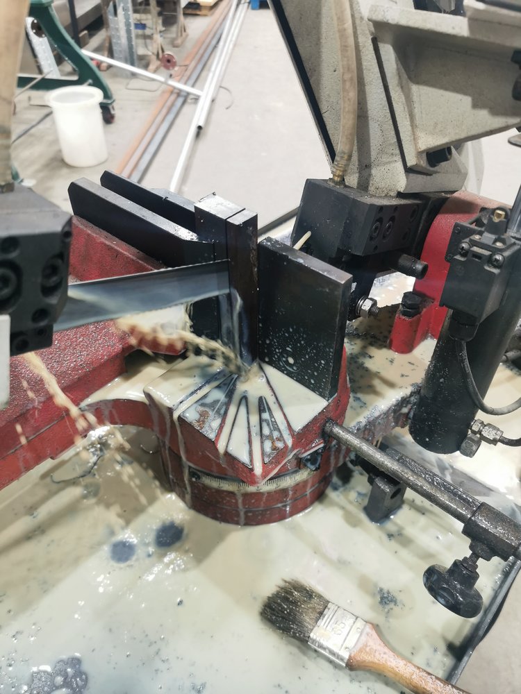

Manufacturing stages. A little tig welding at 110A, a band saw, a grinder and a belt grinder.
