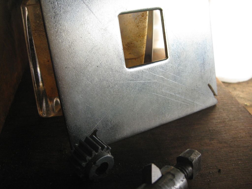

I've set up my lathe to turn it into a milling machine so that I can mill out gear teeth with a fly cutter in aluminium
( if this works well I'll repeat it in Dur-alumin or phosphor bronze .
It works only occasionally , the counter often fails to stay located in th acme thread or the aluminium gear is chaveled away in seconds by the clearance groove along the length of the feed screw ( wrong tooth angle ? ) .

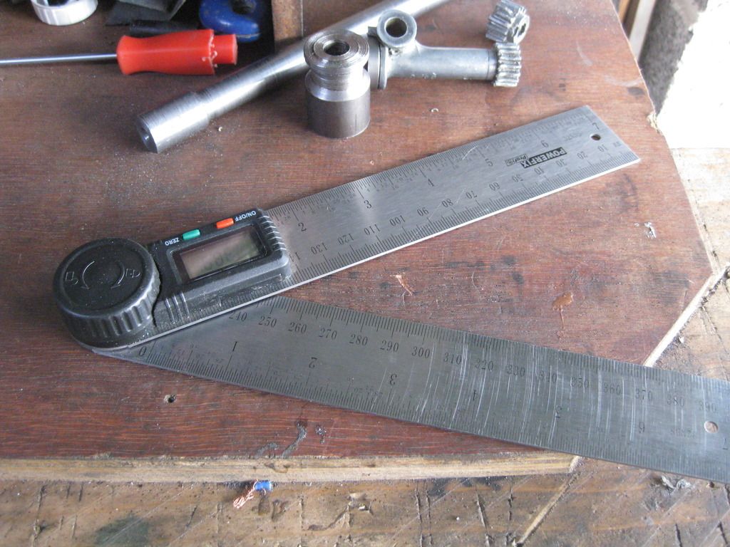

The profile of the teeth appears to be a symmetrical one that is a 60 degree tooth & I'm having problems in getting the 60 degree right .
I've tried free hand grinding the cutter tip but keep getting it slightly acute and off to one side , also the sides are not perfectly straight as they are a tad concave.

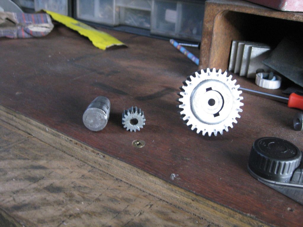

I'm now on my fifth attempt at getting it right .. Every time I've re ground the fly cutter tip I've made a new gear wheel .
There are 16 teeth on the 19 mm dia wheel , it is for the thread counter wheel that runs in the acme thread on the feed spindle so it has to be accurately cut.
I use a 32 or a 64 toothed gear that I have to locate & lock the cutting positions accurately using a turned spindle of aluminium set in the boring bars tool holder on my lathes QCTP for the blank to be fly cut
Do any of you guys & gals have any tips or suggestions as to how I can accurately grind this 1/4 " sq HHS blank ..with clearance angles in to a symmetrical 60 degree point .
All I have is a bench grinder and a 4 inch whizzer , half inch square MS , 50mm equal 5 mm angle iron , 50 x 50 mm sq aluminium bar and some 15 foot of 1" free cutting round steel plus a fish box of various bits of " valuable scrap " & a stack of UK Racers bolts & screws etc.

.....The one that's way to get the fly cutter angle right .
Thanks qraffian , where where you when I needed you yesterday ?
