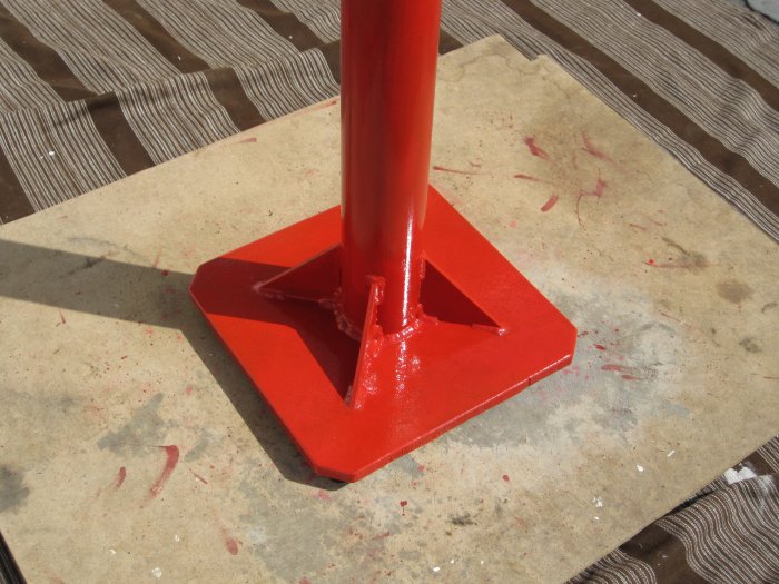

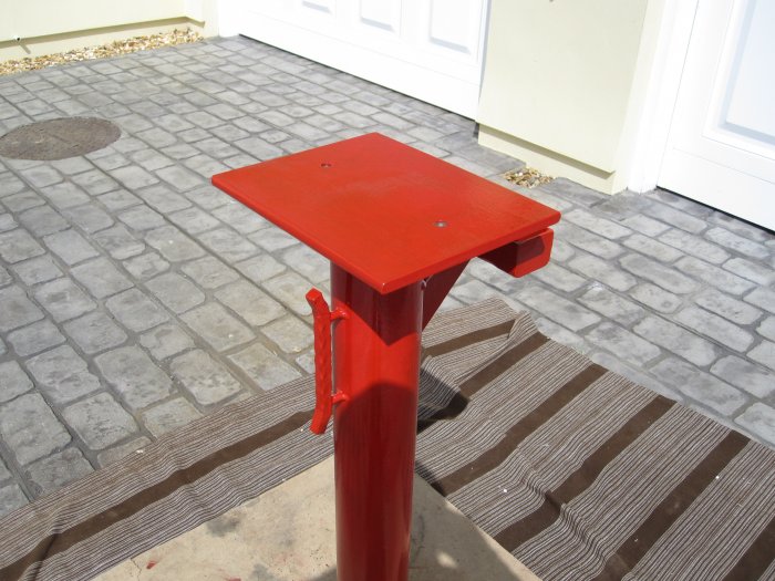

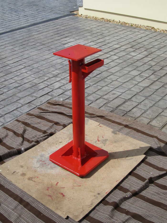

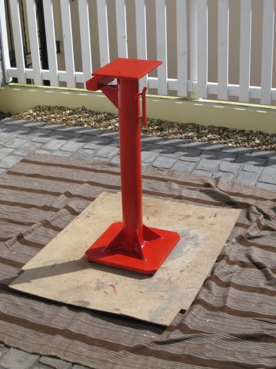

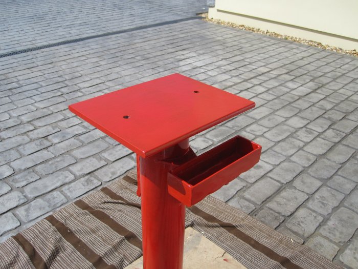

Just finished this one. Base = 20mm thick, post = 3.5 inch tube, stiffeners = 6mm thick, rubber feet, coolant tray = 50mm box section with one side cut off and ends capped and cable tidy = odd bits.
