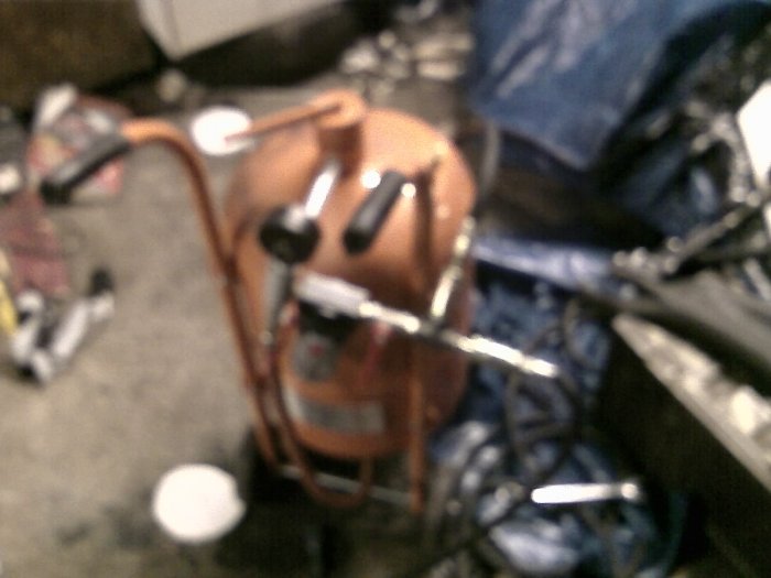

10 gallon pressurised blast pot (ebay, orange one, great but go for 20 gallon)

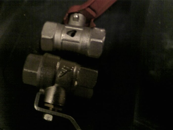

From the blast pot, remove the nut which holds the ceramic nozzle, screw the plumbing valve (outlet on the rubber hose of the blast pot) into the grit gun where the reservoir was (blast pot becomes large pressurised reservoir).
So we now have a 6mm long life steel nozzle capable of delivering large grain abrasive without clogging. The additional benefit comes from an extra 150psi (up to) of air pressure at the nozzle, with a trigger control (still a 2 handed job as the valve from the blast pot is independent of the trigger).
