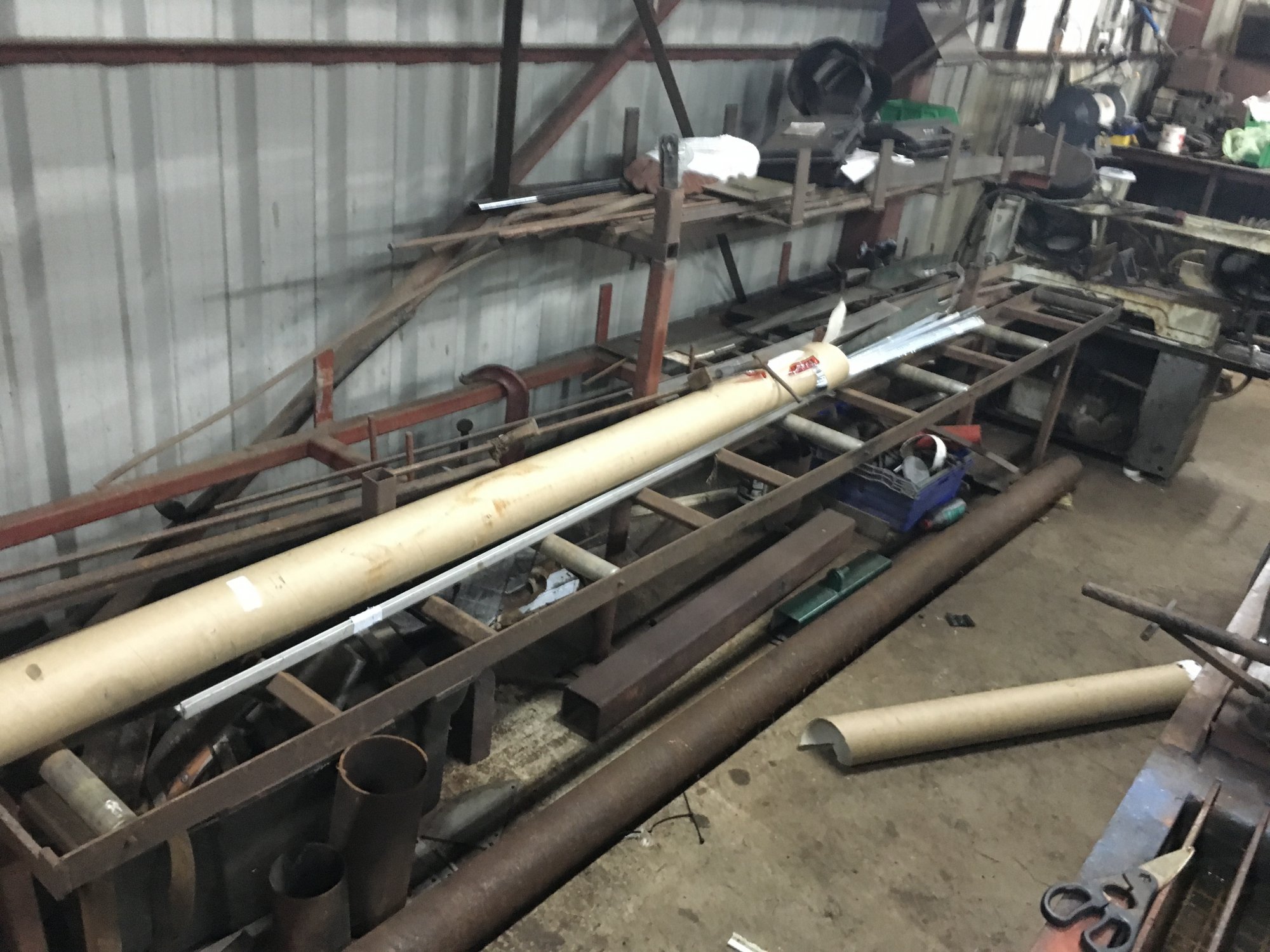

so i bought a saw to make square cuts, but it cant make square cuts unless its fed, so i need to feed it with a roller table.
But i bought the saw this month so I'm broke, so i bought these below for 90 euros.
And now i need to sort them out.
I bought some festool track with me when buying it, and running it along the rollers , it looked pretty good. No obvious deformations that i could spot. I'll run a string along the length of it tomo after work, so i know where im at.
I guess this was made on some sort of jig, if I'm wrong id love to know how its done.
7 of the rollers are screwed. Some have been welded, but it wasnt centered properly so they have to go.
Im cutting it after the broken one below, though 2 and 3 after it are okay, the ones after have been repaired badly.
I intend using a full length on the feed side and 66.66% of the other one on the far side, or thereabouts.
Like below. Imagine please the square box on top is the bandsaw. I'll make long continuous low table out of the two sections and mount the bandsaw midway along.
So what i dont know is, can these rollers come apart? If they can, i can clean it up properly, if not, ill have to work with it as it is.
I've realised that i can take a slice out of the top rail of the steel and replace rollers that way, and the remaining bottom face of the hole will keep the rollers square / even / spot on.
Any and all insight or advise appreciated, regards.

If your rollers are all the same length and fit between the rails then they are parallel enough.
