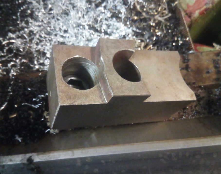

Here is a soft top jaw that has been bored to suit some hauler plates.
And here is a bit I made up instead of just using a disc, it makes it easier to remove without having to remove a soft top jaw as CNC chucks usually only have about 5 mm travel per jaw.

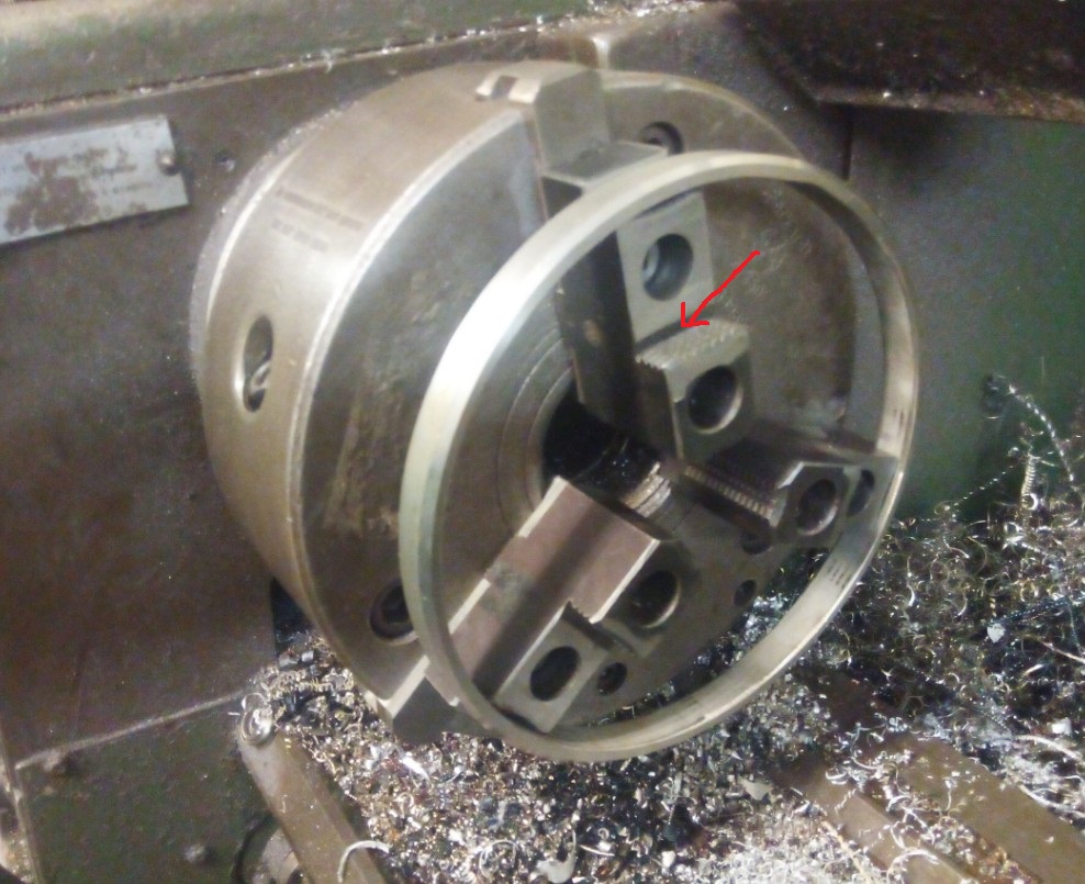

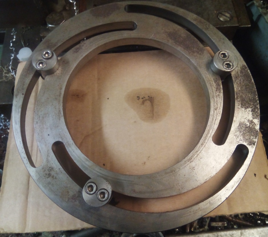

Then you can also use the holes that clamp the jaws together when you have an adjustable ring like this one I made. You slide each pin round in the slot and then place them in the cap screw holes on the jaw.
That can be used for loading the chuck jaws both ways, so for doing both the faces for external part gripping or by loading the chuck the opposite way for internal part gripping.

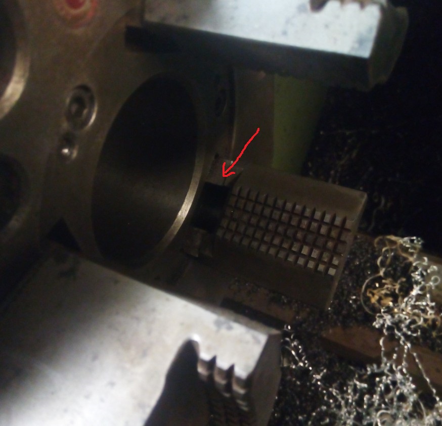

That can also be done with a ring such as I use on the manual lathe, see below pic which would be for boring out the section arrowed, again usually on soft jaws but I actually used it on these jaws as they were not matched so had some runout.

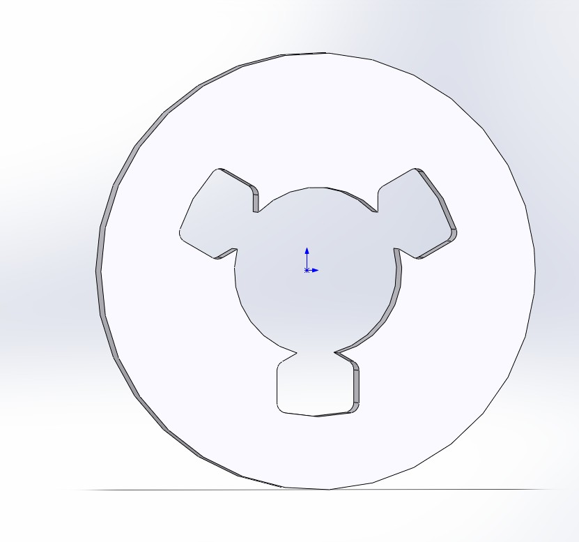

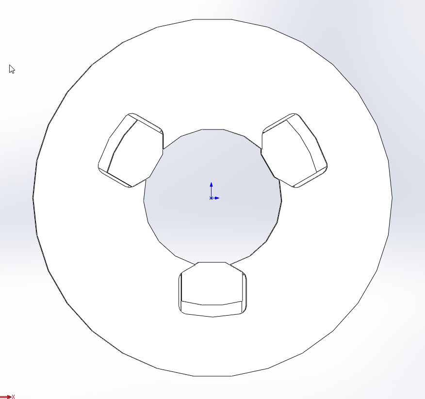

Years ago I made a part for doing the chuck on my Colchester student, cant find the part but here is the drawing.
It gripped on the side angles of the jaws so that it left the face clear, maybe this will show how it fitted.
