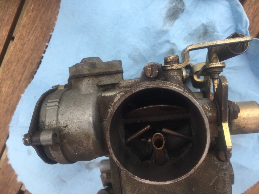

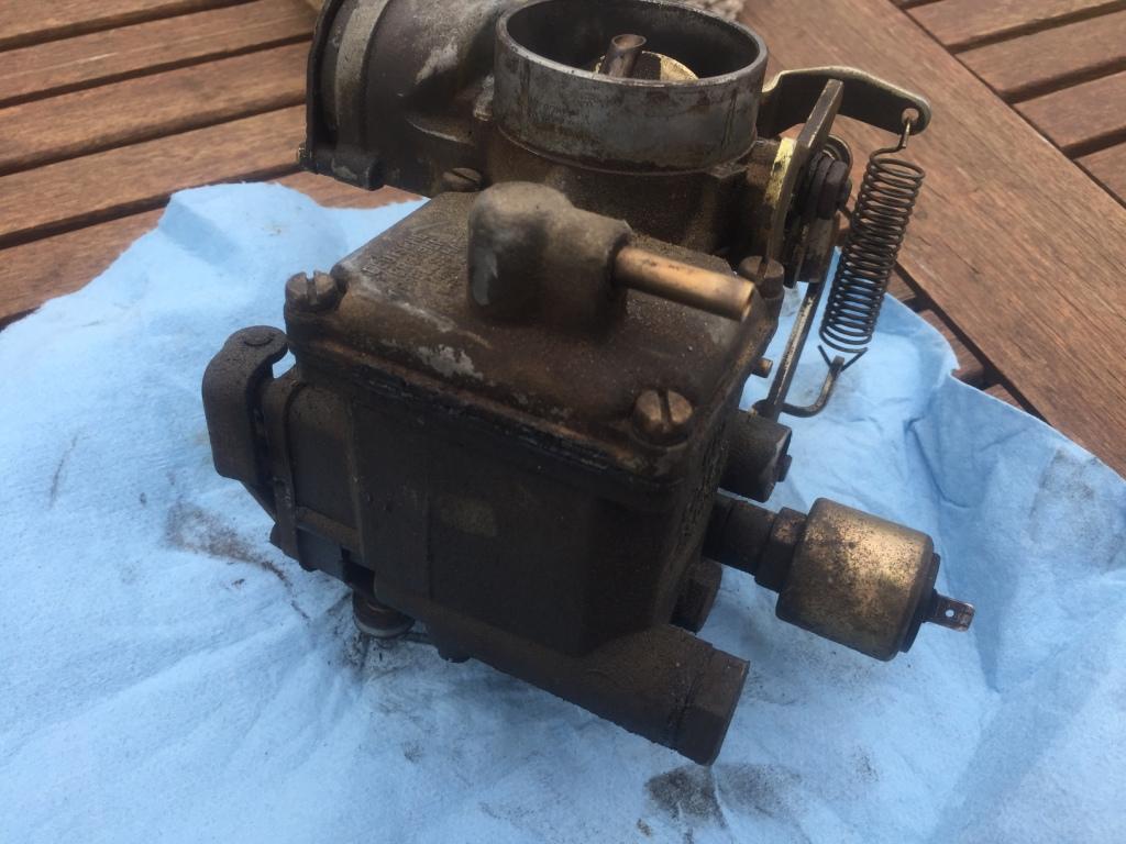

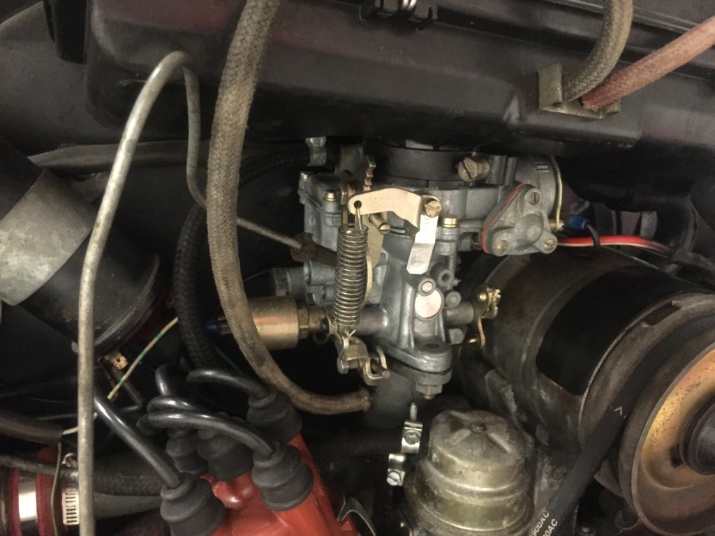

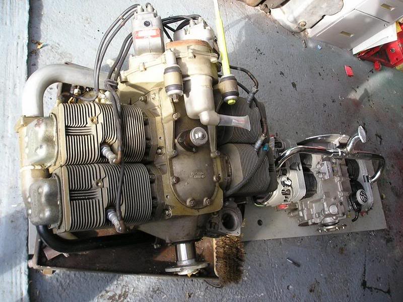

First thing I did was strip, clean, and rebuild the card - it was minging. First two pics are before, then into the parts washer for a paraffin scrub, then the ultrasonic cleaner for 10 minutes for each major part.
Looks pretty good after - refitted, and car runs the same, badly.

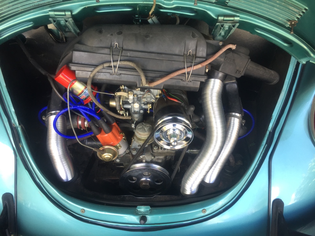

Decided to fit electronic ignition - new coil, plugs, leads, distributor ready-fitted with pickup, etc.
Tried to get the first plug out - oh dear. Every plug was rock solid in it's head. I'm guessing the previous plug change was aborted over worry that the plug would snap. God only knows when the plugs were last changed.
After a lot of improvisation with socket sets, and extension bars, I now have a new set of plugs in. Took me 6 hours to change the friggin plugs! I still plan to run a 14mm tap through the heads to ease future changes.
Anyway - I then set the timing, and the thing drives like it was new.
