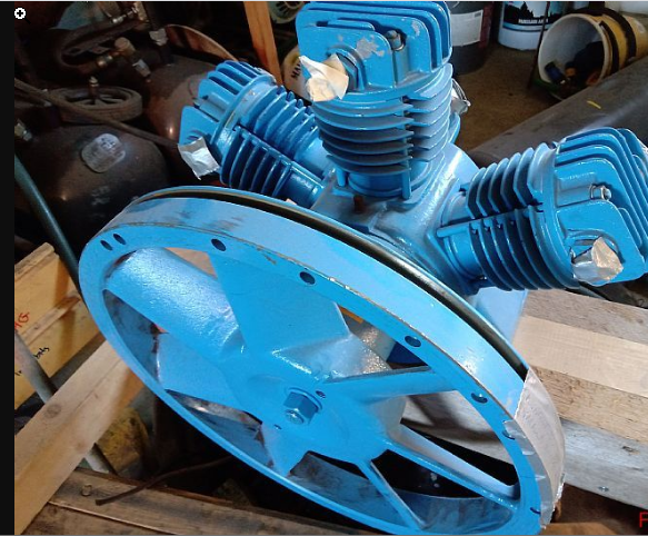

Got this 96l tank to replace my old 25 liter tank that is old and looking a bit worrisome on the inside. This is a coolant compressor tank I found cheap, made in 1999, rated for 26 bar so nice overkill on the specs, looks great on the inside too. The idea is actually to mount this one upside down, because the top valve (1) is perfect for a drain valve, with a length of pipe before a valve water should run into the pipe and hardly remain in the tank even if you forget to drain it after use. The old base plate will then make a new mounting point for the compressor block, making for a very tall compressor that uses very little space.
I'd like to use connections 2 and 3 for inlet and outlet but the connections are a bit odd, not seen this size before, 44.3mm, which according to wikipedia is a 1-3⁄8" BSP fitting (we use BSP for pipe threads in finland, everyone but the yanks do afaik). Anyone know where I can find a female adapter, I'd like to neck it down the much more common 1/2".
