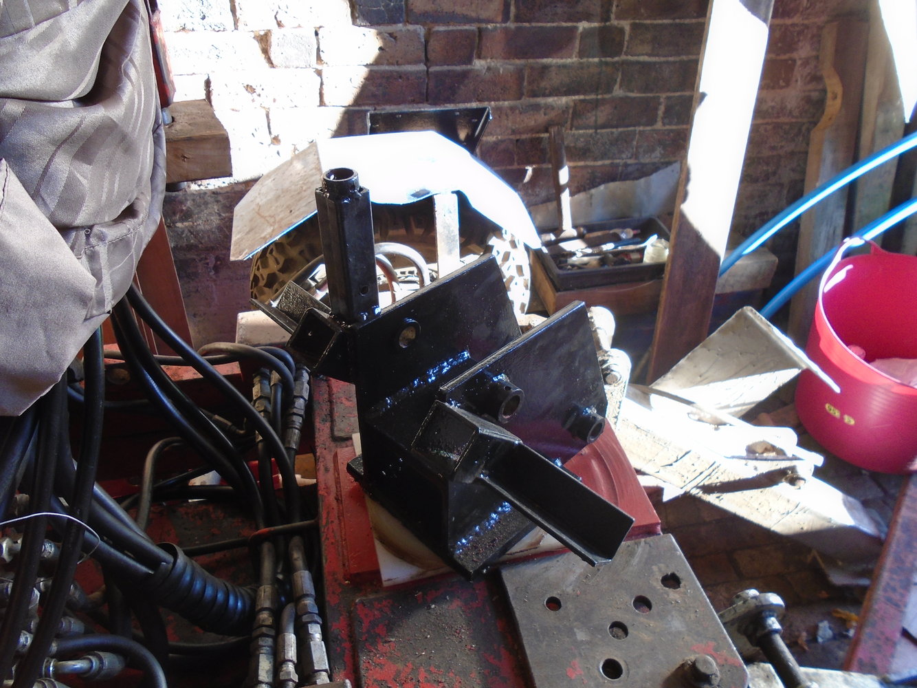

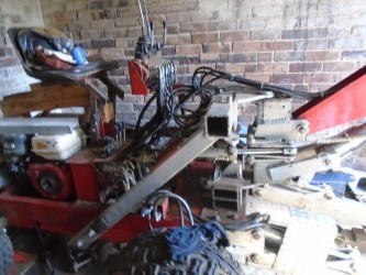

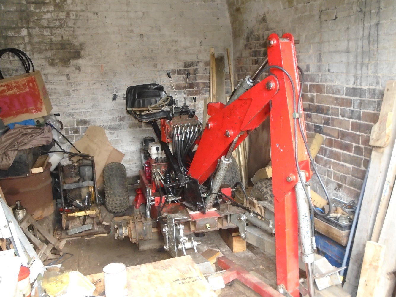

I bought this machine for £400, the original slew system had failed & been replaced with a system of a Twose farm hoe, this did not really work as far too heavy & slew centre had been brought forward by 21 ins leaving it front heavy. I got dimensions of original kingpost off another owner, did wooden mock ups to prove system as boom ram most be no more than horizontal to clear table, & rear of boom no more than vertical to not foul spool block. Some of you may remember my post here to get my big lathe back gear going

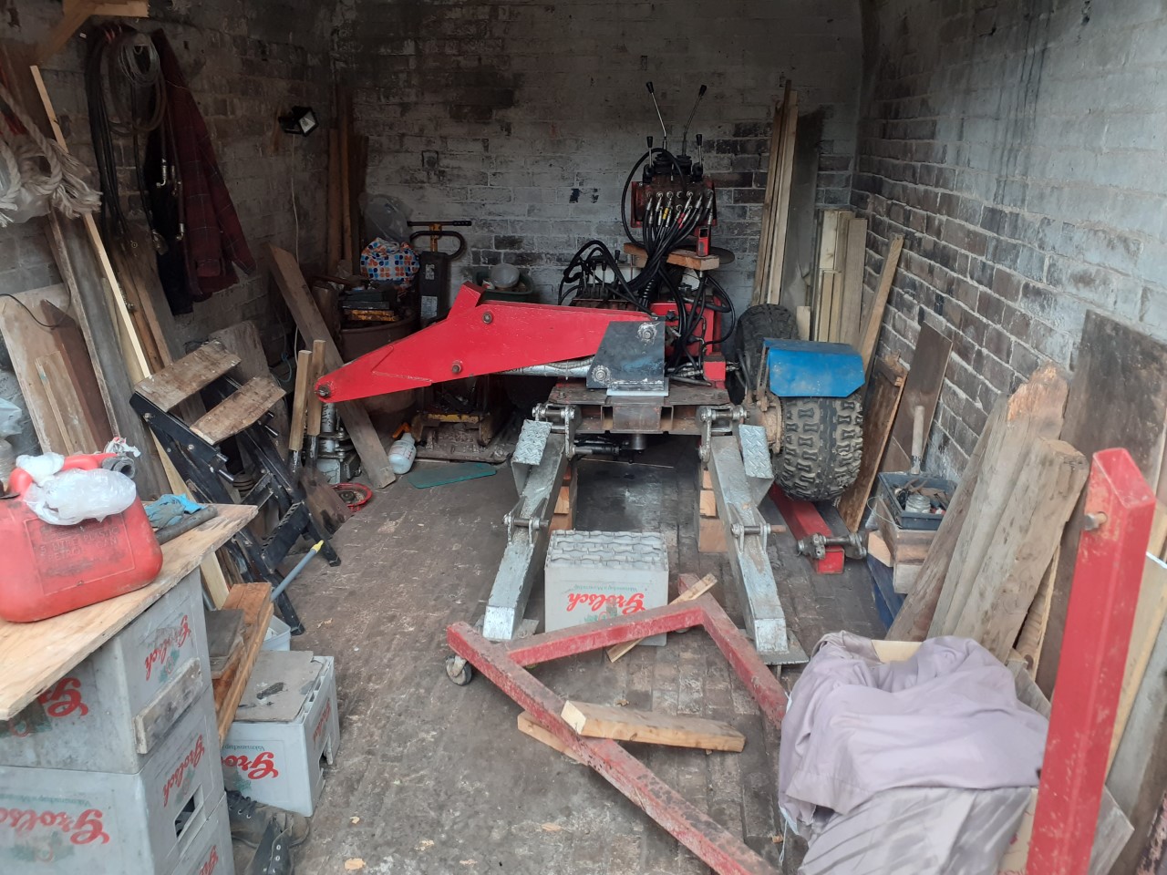

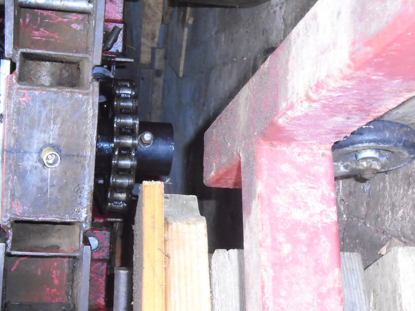

Once this was OK I could start machining plates etc. This was how I spent lockdown. I had the original slew rams as spares & the chain. I had to do the math to convert 13'' of ram travel into 180 degrees on a 1.25'' pitch roller chain, this proved to be a 19t if i remember correctly. The original slew design on these machines used a reduced post & a keyway, this was prone to failure so I kept the new shaft as 3'' all the way down with forces from the sprocket being transferred by a 0.5'' cross pin from the sprocket collar
