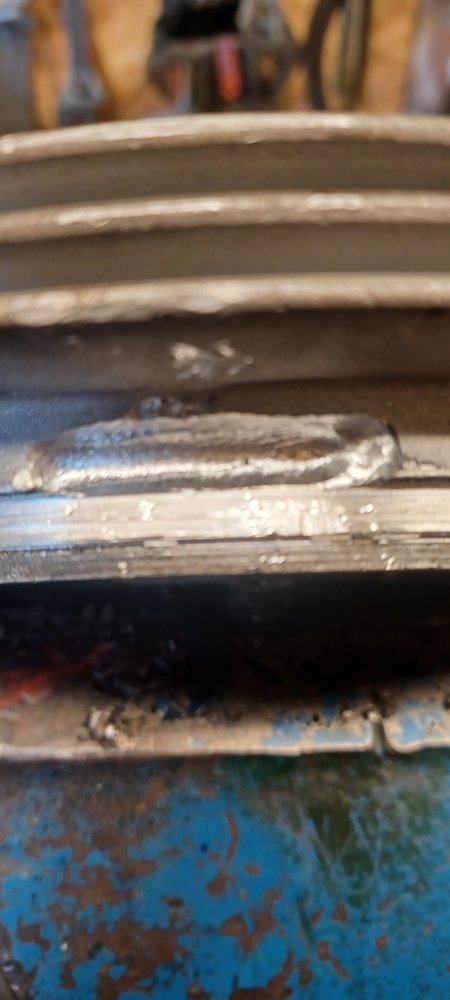

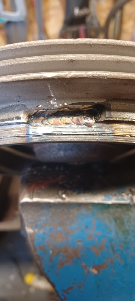

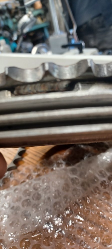

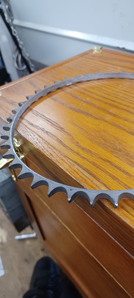

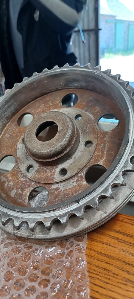

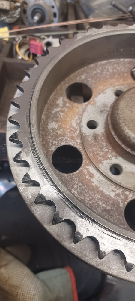

today i machined the worn 42 tooth sprocket off one of the rare alloy finned drums initialy i was going to braze the new ring on but i was worried that i might melt the alloy fins with the heat for silicon bronze
i came up with a safer idea
i machined away the alloy at 6 points to bare the cast steel drum
i preheated to 200 c then laid a bead of 2mm inconel 625 wire so i could now get a fllet weld at 6 points at the back of the sprocket front face was prepped with a long taper at 6 points between the rear welds more pre heat and tack back and front , rear fillets were not easy acess but the old bent tungsten with a long stickout allowed me to get the required wash up the sprocket , front weld were done in 2 passes to flush then the groove for the brake drum was re cut and when cool distortion was minimal and no cracking
2109[/ATTACH]
