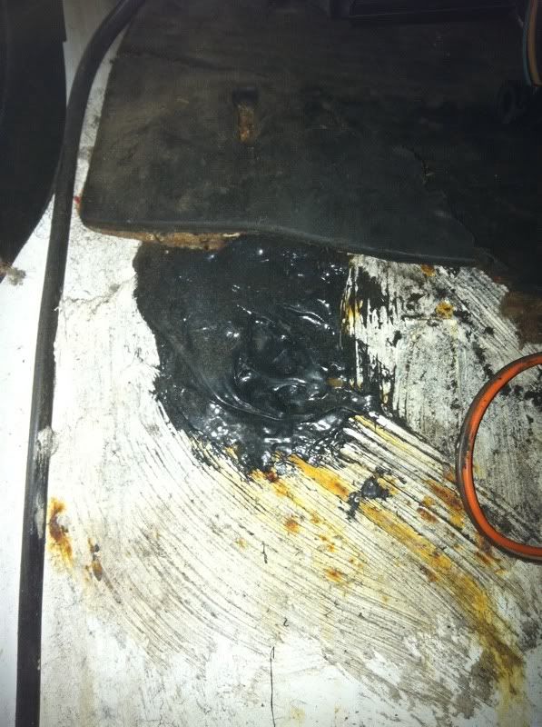

The guy that did the body work did a bodge repair on the driver side wheel well (the left side of the car as it's a US vehicle).
I think that back in the day, there was some rust behind the inner wheel arch which corroded through the first layer of the firewall and then pierced the inner skin of the truck. When he patched the hole, he liberally smeared some kind of sealant between the two layers and this appears to have caused a blockage in the drainage of the truck. I was left with a bit of a headache.
Here is the panel patched up and hidden behind the inner wheel arch.
The rust stain suggests something sinister going on behind there.
Here is the mess on the inside of the car. The black goop is GM urethane sealant that I used in the first attempt to plug the hole. The water still found a way in.

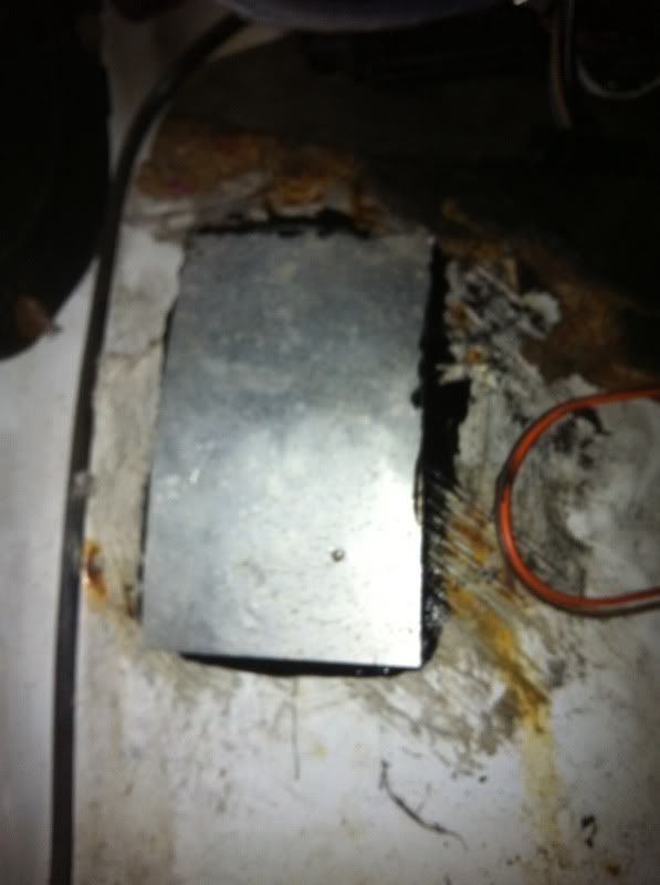

So I took a Dremel and cut out a patch of material behind where the water was visible coming through the urethane goop on the inside. It just had nowhere to go. After cutting, I could see that there were two layers and they were bascially closed. Any drain holes were blocked as well.
I covered the hole with silicone sealant and then pressed a 5" x 3" aluminium plate over the top for now.
The view through the hole I cut after I put the aluminium on it:
So... what do I do next? My plan is to get the car into the garage and take my time on it. I think I need to cut out the crap panel from the front surface and also a panel about the size of the aluminium one that is in the interior.
I plan to get some 2-3mm mild steel sheet and after getting the size right with some cardboard, I'll beat/hammer it into shape and try and replace both the inner and outer skin. I am aware of the potential heat issues so plan to have a damp towel in the area when doing the interior.
