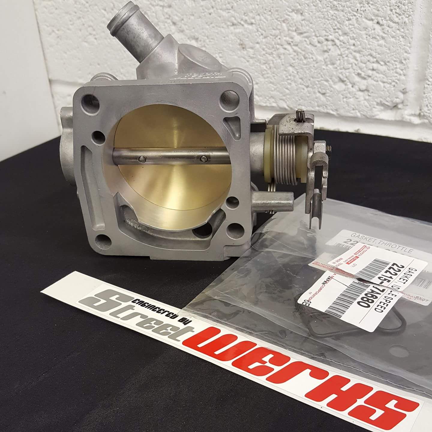

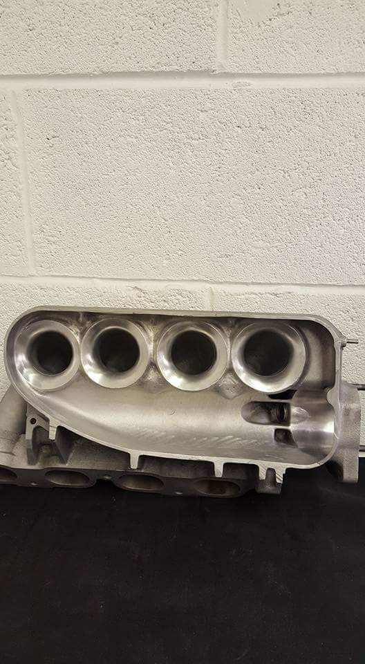

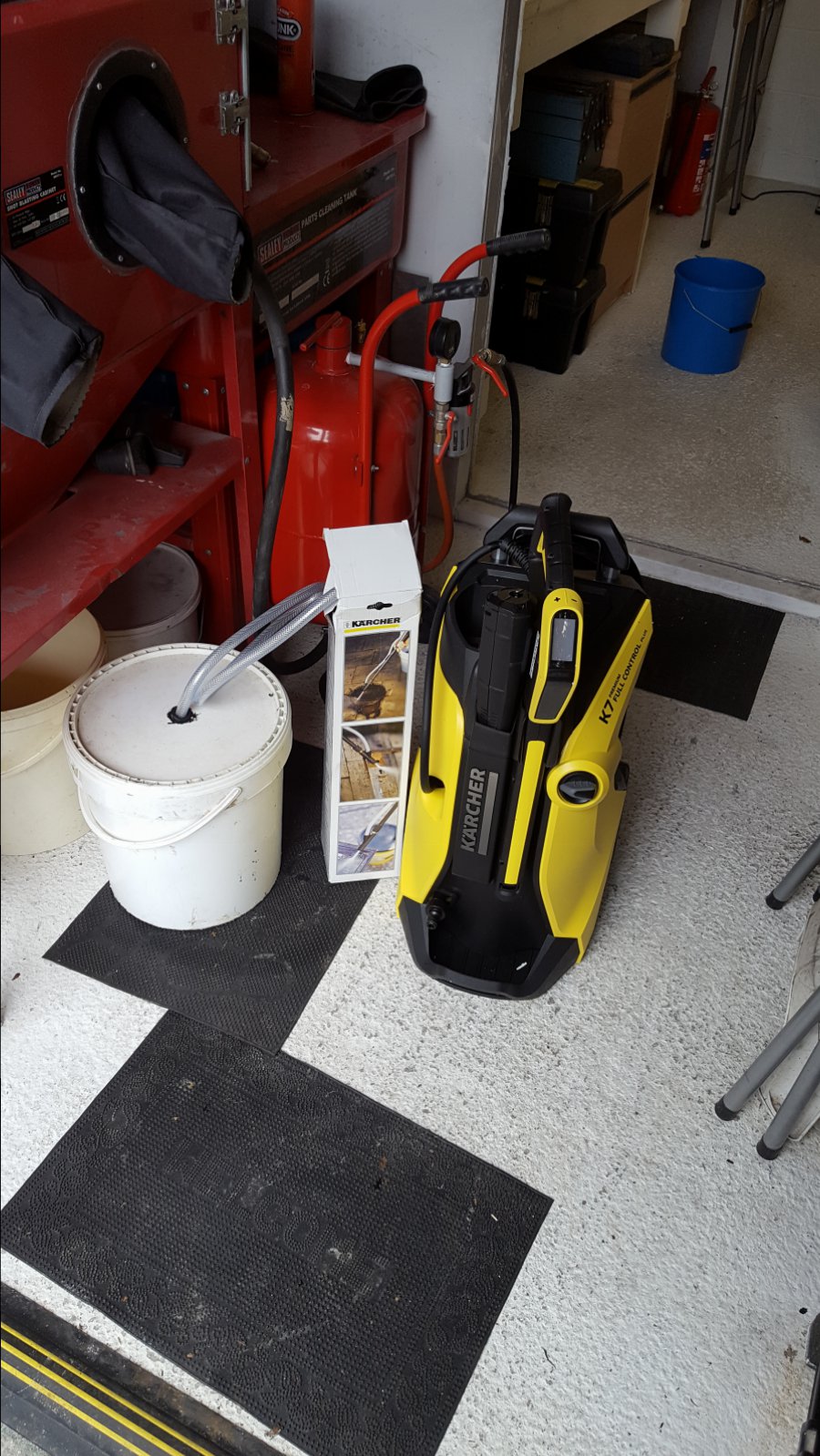

I have the most powerful domestic Karcher pressure washer and recently purchased the Karcher attachment for wet blasting. Basically most of my work is porting intake manifolds and machining large throttlebodies to go with them. I stock cores of the manifolds to make it easier for clients and also I send my work worldwide so sending back stock manifolds isn't cost effective due to shipping costs. Now being I get manifolds from breakers and some are in a right state my plan was wet blasting to clean them up and remove all contamination and also bring them up looking fresh. After porting I fully degrease the manifold as I cut the plenum open to port so it needs to be clean for welding the cast back up and I then glass bead yo they look like new.. I also do a bit of powder coating with the plan of using the wet blaster to clean and give profile for the coating to adhere to. I usually use aluminium oxide in 80 grit which gives the perfect profile.
So with that in mind what grade glass grit is recommended
thanks
