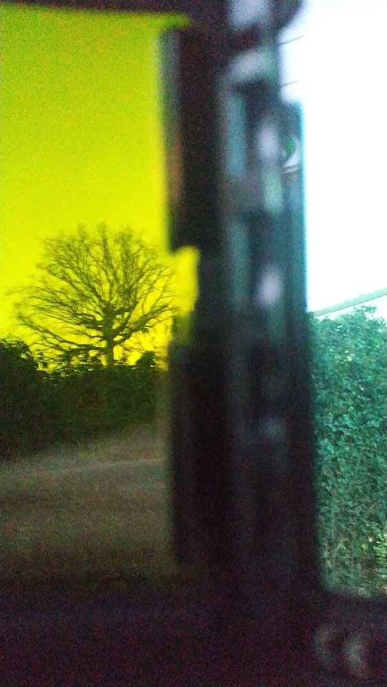

Phone looking through the ADF is very clear, very little tint. It goes down to shade 5 but 9-11 seems to suit my work best at 40-150A. Camera right up against the filter:

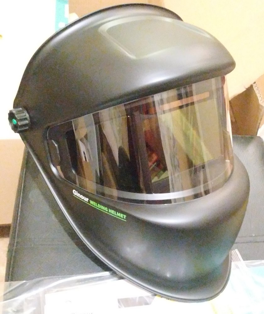

The side windows are plain tinted green, and the right shade for the position. Very useful for seeing stuff around you. I would not go back to a mask without them - if I had to, I would be buying some filter glass, cutting a hole and gluing it on.

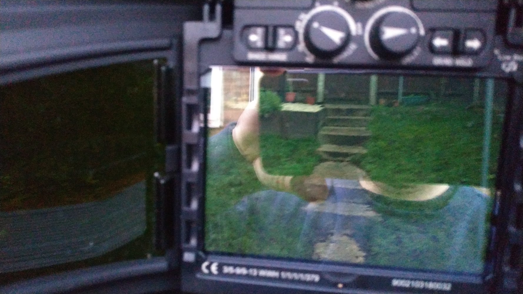

The adjustments are inside, I rarely touch them. If you adjust often, it might be a pain but I like it, I can't accidently change the shade, I take it off to adjust. Headband is comfortable, lots of adjusters.
This is is a good bit clearer in light mode than the other true colour I used, the GYS Alien XXL and about the same when dark. Both good masks, but the side windows on this meant its the one I picked up every time.
I got mine at £33 but the price has gone up, currently has 10% off voucher to £45.
