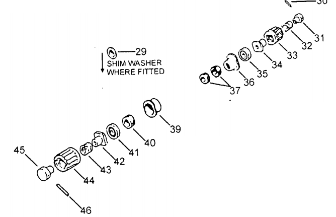

I'm in the process of rebuilding a Victa 550 Pro self-propelled mulching lawnmower - they go for over a grand new and I got it (knackered) from an industrial auction for £40. Time will tell whether that was a good investment!
I've rebuilt the gearbox now, which I'm chuffed at, and have been trying to get one of the idler bearings unstuck (it pushes the wheel forward when power is applied and freewheels when power is released, or you're pushing the mower).
UK supplier wants £77 for one plus a tenner delivery.
Emailed a company that does mower spares in Australia, where Victa are based, and I've bought two (the left and right one idle in opposite directions) for £60 delivered to sunny Scotland. Figured at that price I may as well replace the other one as well.
Pays to cast your shopping net further afield sometimes
