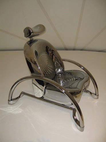

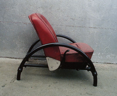

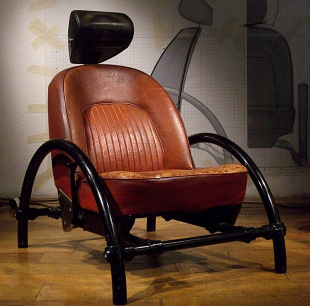

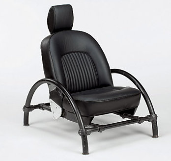

Youd want that like 3mm thick, any thinner and i can see the clamp screws in the fittings squashing the tube, and working loose over time.
Bit far away, otherwise id be able to help you out. As Hotrodder said , you want ring rolling, rather than tube bending.
How about adapting the design, and making it out of straight sections mitred, say 5 to each side of the chair?
Would look good and make it more original.
