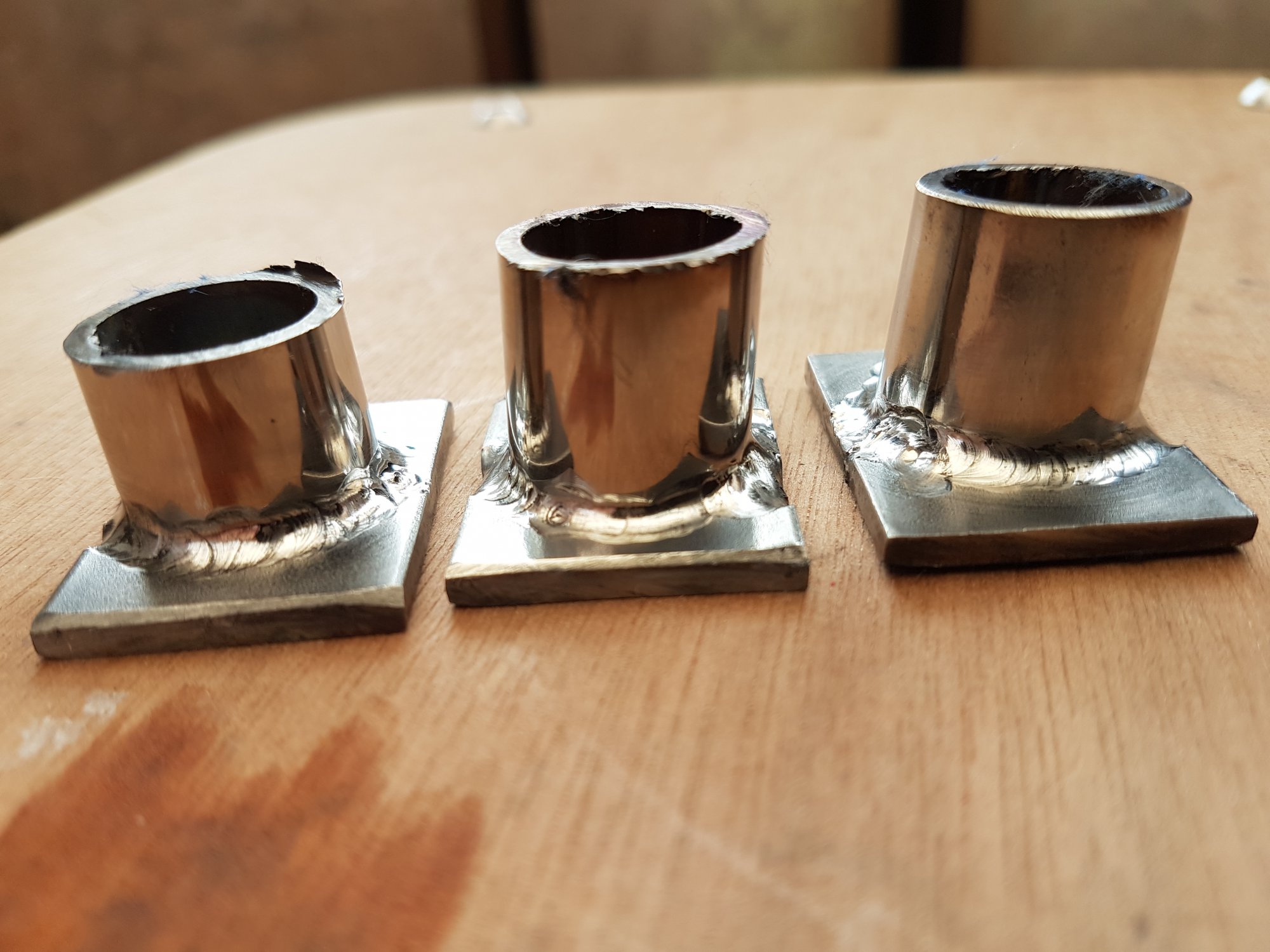

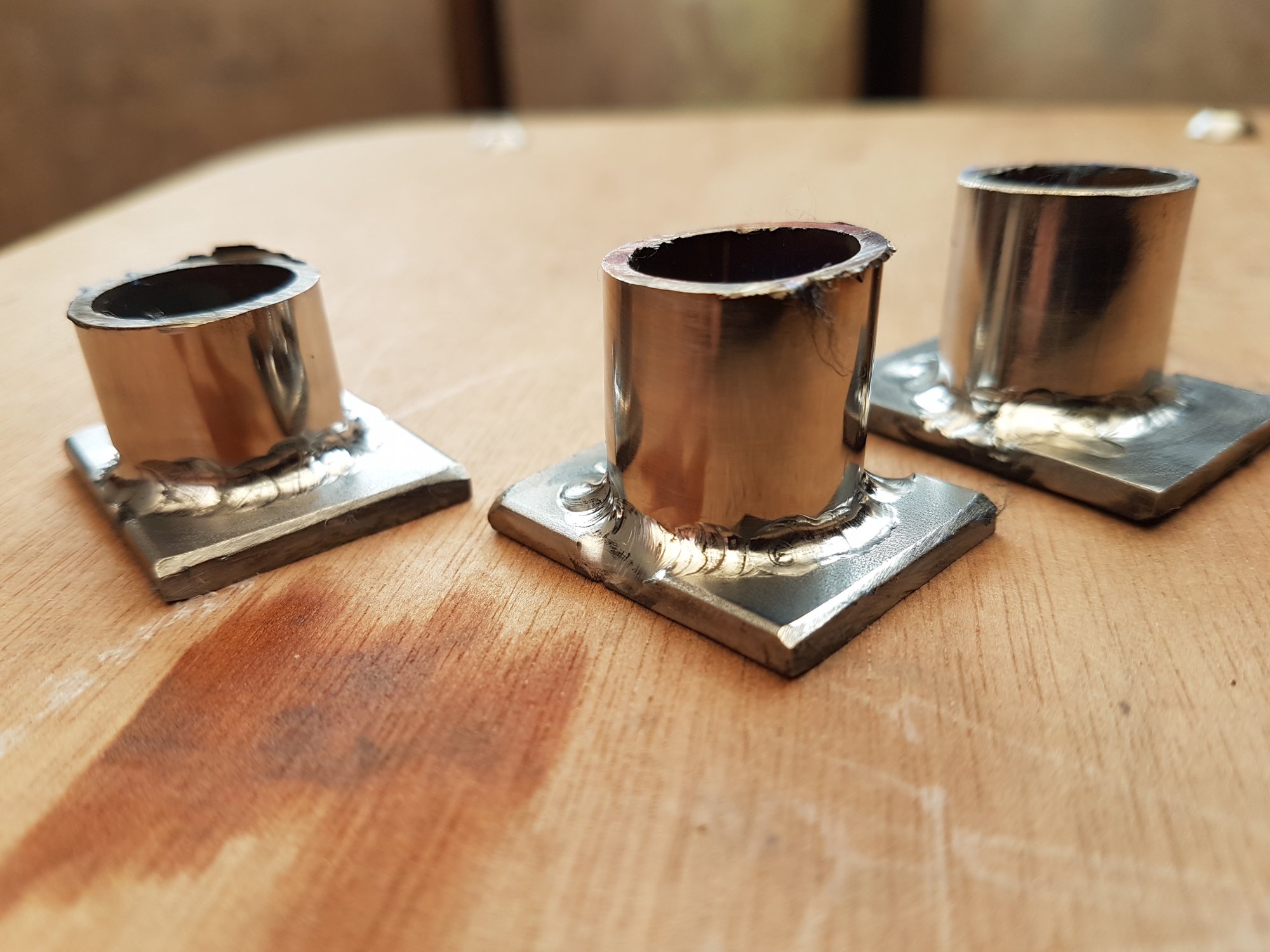

Not that good but i am getting there with my Tig welding, been practicing again for a few hours. These will be my bow and hand rails, so 3mm feet and 1.6mm tube, not easy with the different thickness. I keep blowing holes in the tube but i manage to fill them and now i dont go so slow and high.
I pickled them and a quick buff on the grinder/buffer.
How do i stop messing the edges up ?
