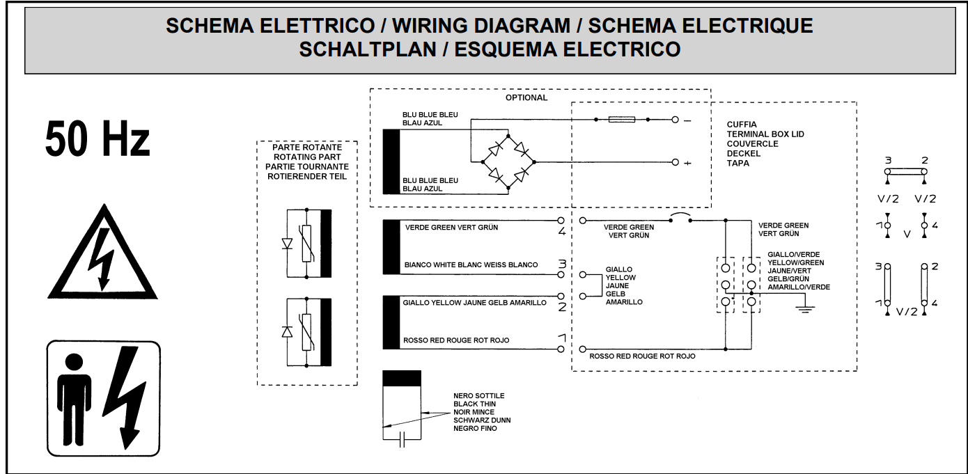

Hi Folks,
Need a bit of advice with a generator that I have acquired.
It currently outputs 120v and I need to rewire it to output 240v
If its any help its a Meccalte SW15 alternator.
Would I be correct in that White and Yellow (3 and 2) need to be joined together? Then use 1 and ground and 4 and ground?
This is a single phase generator.
Appreciate any advice, thanks.
