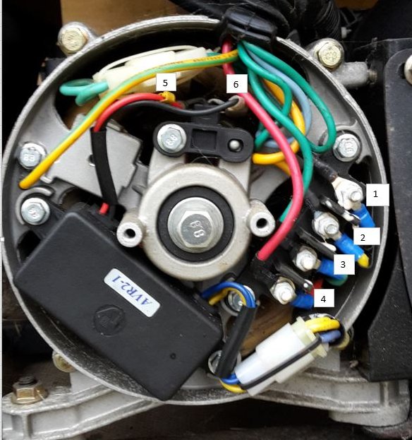

Hyundai generator has run fine for 4 years (serviced annually) powering lighting, kettle etc. at the stable then last week lost output voltage completely, normally it would point to a failed AVR, but a few hours online research makes me wonder if it's the rotor at fault?.
Generator with test points marked (AVR disconnected for tests)
VAC readings were as follows:
1 - 2 6V, 3 - 4 6V, 1 - 4 12V, and 5 - 6 18V
From what I have read/watched, anything over 10V across brushes (5 - 6) points to a duff rotor? brushes and slip rings are in good condition. A failed rotor would make repairs uneconomical so any advice or more tests to carry out would be appreciated.

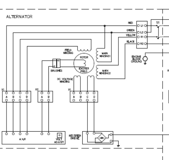

Section of circuit diagram
Cheers.
