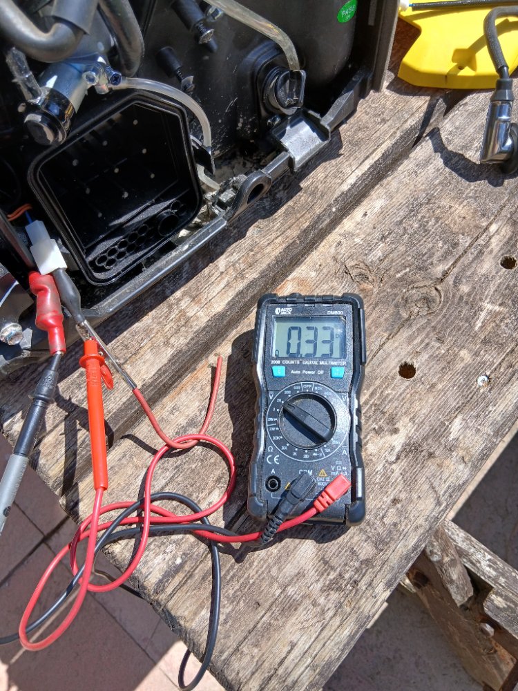

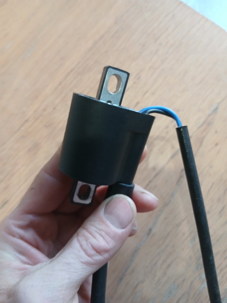

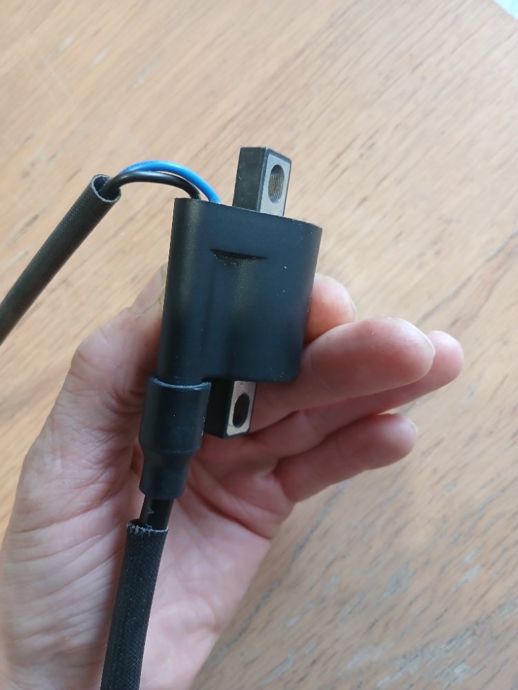

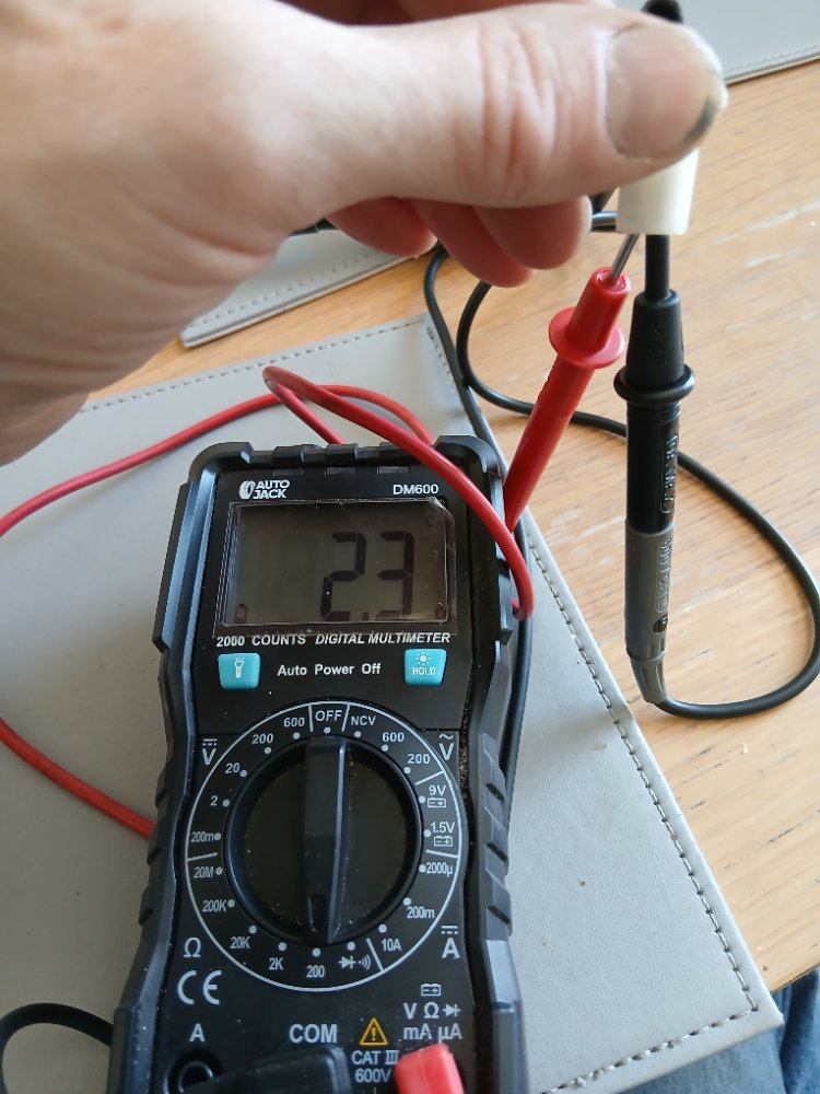

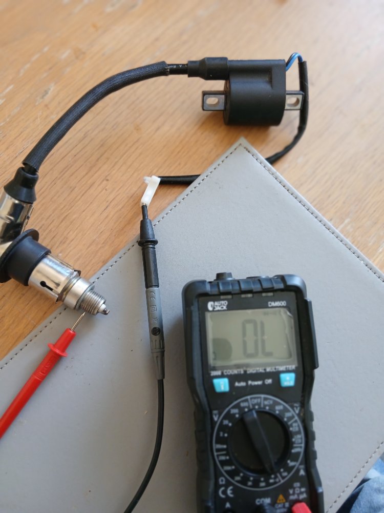

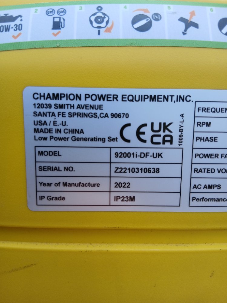

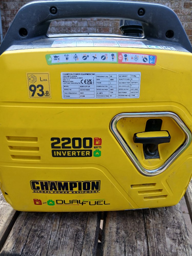

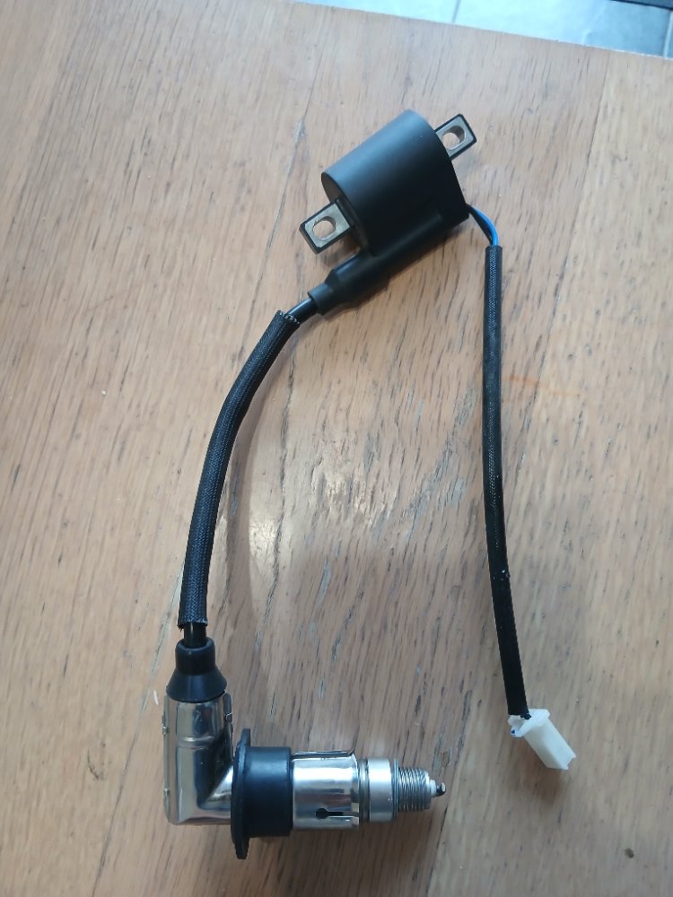

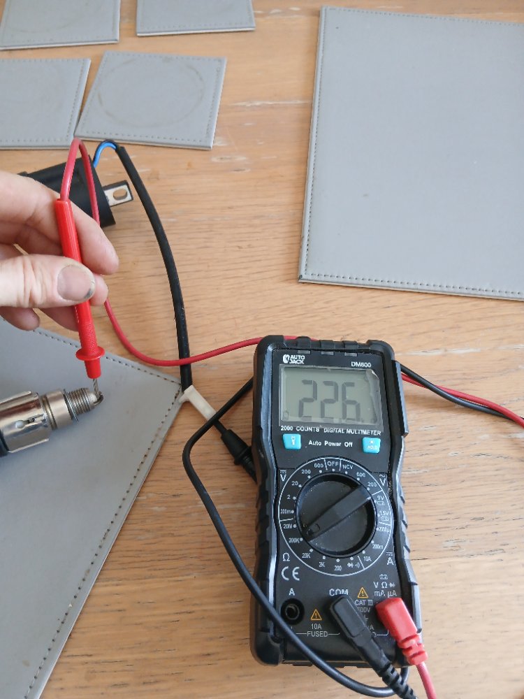

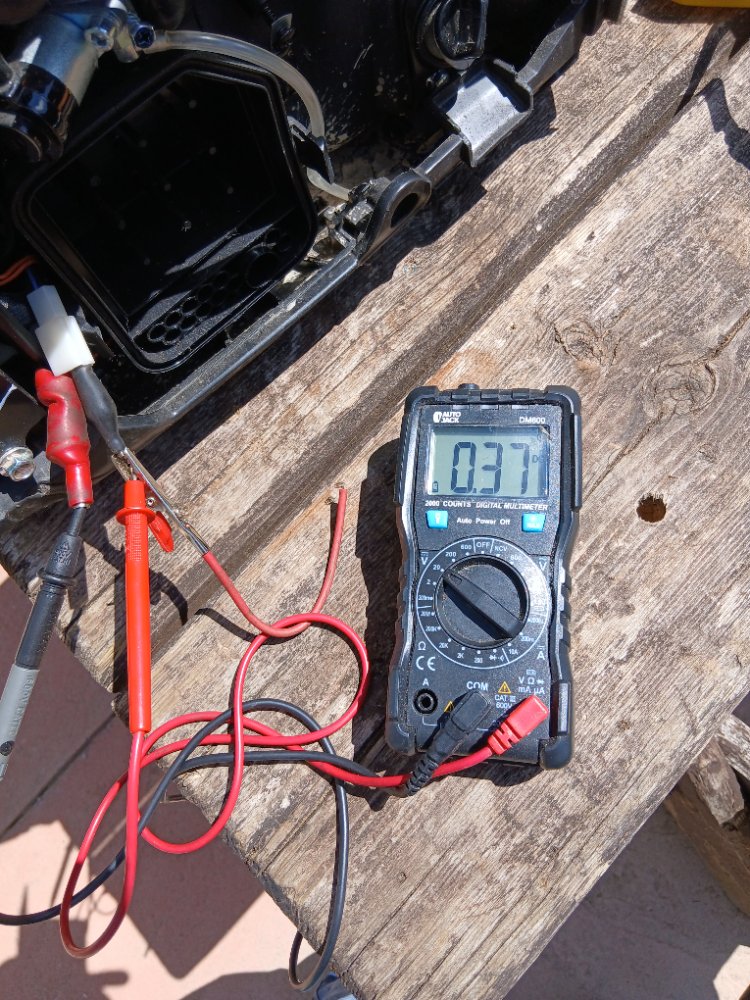

Hi everyone,
I've been given a champion duel fuel 2200 inverter generator and I'm trying to get it going? I've found out it's not generating a spark, I think I've worked out the second winding in the coil has failed when I used my multimeter, the only replacement I've found is in the USA £70, I would like to ask the collective if it is possible to use a different coil pack and wire it in and which one would be best to use
Theirs identification numbers written on the coil are
RoHS ZD31N 100097811-0001 LJL221027
Many thanks
