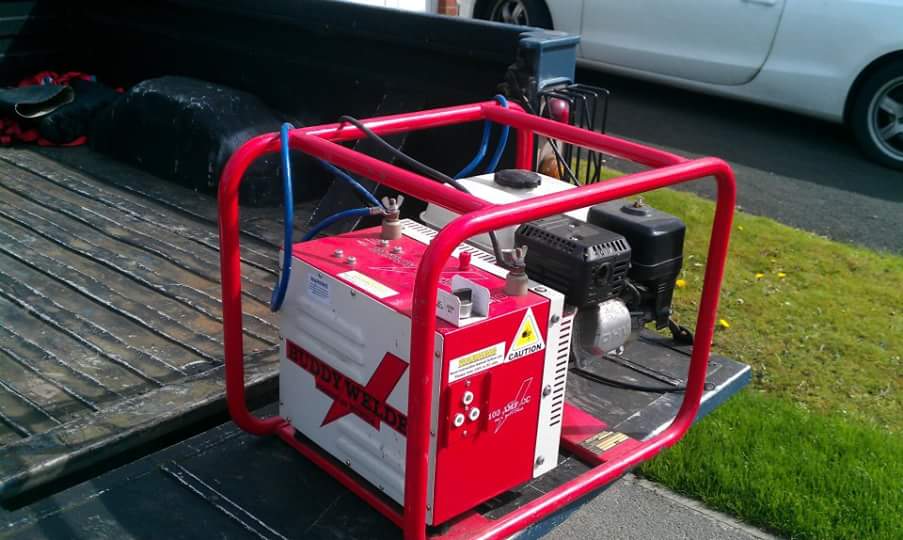

Evening all,
Years ago I bought a Honda powered 100a welder generator, great wee machine, handy for working away from power as she will power a 4" grinder too (see pictures), I believe she is old as I've never seen another like it

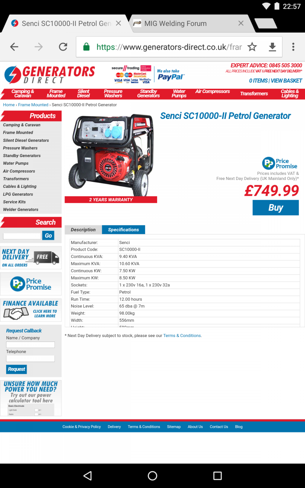

Last yeah as I moved onto working on heavier jobs I bought a Thermal Arc 175se, can't fault the machine and it is nice for the extra capacity, I'll add the spec sheet in a picture too
The bother I'm finding is the little generator running a Murex 6013 2.5mm is I find it struggles unless the engine is doing max RPM so I was pondering whether a senci sc9000-11 generator would run my thermal arc or if I'm wasting my thinking time? Biggest rod the thermal arc is quoted for is a 4mm, unlikely I'll use it, normally 2.5 or 3.2's I work with.
Also has anyone had any experience with senci products, can't find a review anywhere?

simple. Most manufactures have a generator rating requirement for their machines, be it for stick mig and tig. The problem with generators is two fold. Diesel generally have a greater revolving mass and better govenor control, means easier starting due to the stored kinetic energy, and the type of alternator fitted. Most small gensets have cheap alternators which do not have good overload capacity (starting capacity) so when you startup or strike an arc the voltage dipps as well as the frequency. This is why they suggest an oversize genset to compensate for these deficiencies. The newer invertor machines are much kinder to the supply and you can use smaller sets to do the same jobs. The transformer type machines basically operated as a capacitor and pull a higher inrush of current on arc up.
