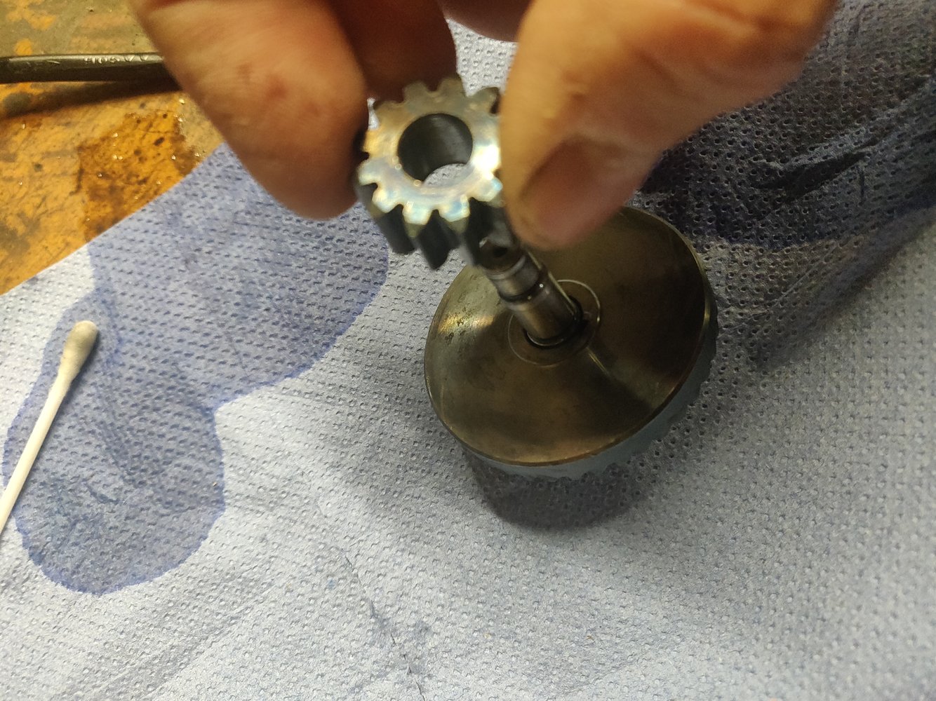

I bought one of these "Chinese standard pattern" metal mitre bandsaws. Same saw is sold under many names. It was an absolute delight to use, it cuts quietly and no sparks. But today it had a total loss of power, the motor turns but the blade will only move if there's no load.
I took it apart despite warranty as I'm curious. Theres a pair of gears.... holding one gear using copper clamps I can still turn the other gear. I used a float and separated the two and there's no keyway. Surely this isn't an attempt at a slipper clutch or something?
Edit: I've cleaned the gears and applied loctite because I need it to live on another few weeks. The quality of these things is bad, the casting is ultra thin, missing bolts, stripped threads, one bare live wire floating around.
