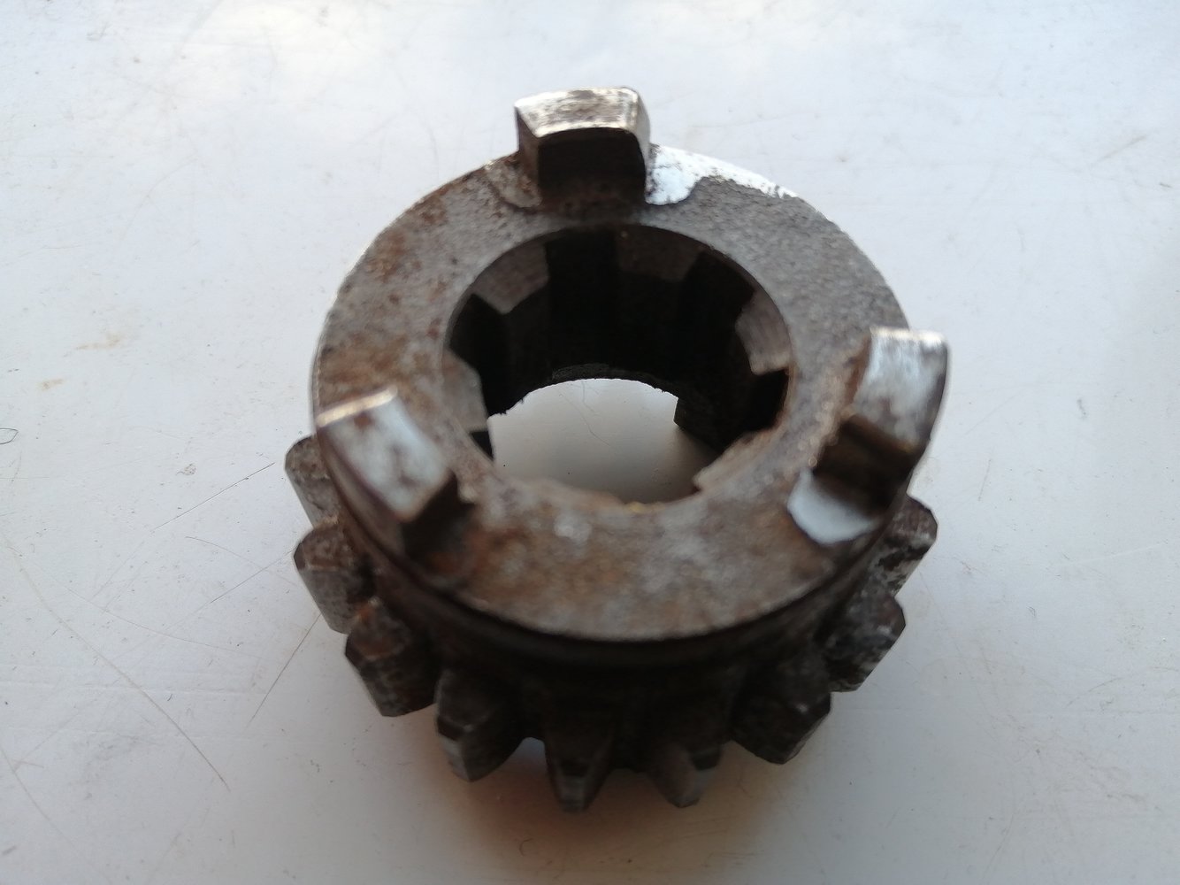

The first thing we need to get our heads around is DP and Module. I think we're getting there, so this morning we tried to identify a couple of gears from a 1980s Yamaha YZ. One needs replacing, so it seems a good place to start.
But - my calculations leave us unclear as to what the gears are. I'm assuming Module on account of the year and source of the bike, but the numbers don't look right. Can you take a look at the pic and let us know if we've got something wrong? Neither Module nor DP seem to match the charts properly.
Thanks, C
