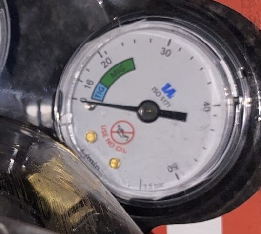

Hello all,anyone recognise this brand of gauge? It looks like 1A
I'm just wanting to replace the pressure gauge
What you show is not strictly a pressure gauge. If it were a true pressure gauge, it would be graduated in units of pressure. It is graduated in litres per minute, which are units of flow. The scale that is on it is non-linear: from zero to 30 is not half of zero to 60. It will be specially made to go with a regulator and is unlikely to be available as a separate spare part. To achieve the same (actually considerably better*) functionality, you can remove it, determine the thread on it, buy a blanking plug to block the hole and replace it with a proper argon flow meter (e.g. https://www.weldingsuppliesdirect.co.uk/flow-meter-0-15-lpm.html). Choose the one to suit the process - 0-15lpm for TIG, 0-40 lpm for MIG.
* Look at what percentage full scale deflection the TIG part covers - it is hardly high resolution or finely graduated. Compare with a proper flow gauge which you can easily adjust in increments of 1 litre per minute
