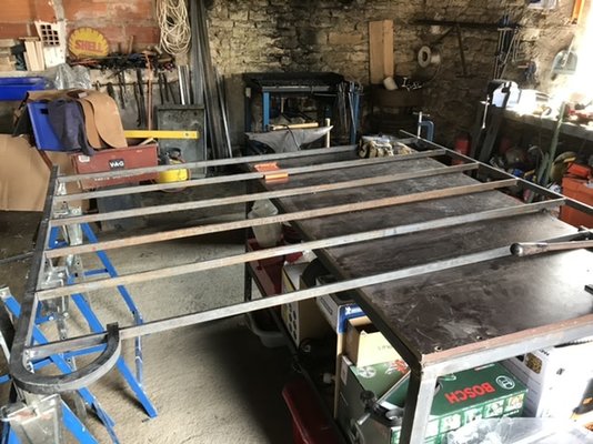

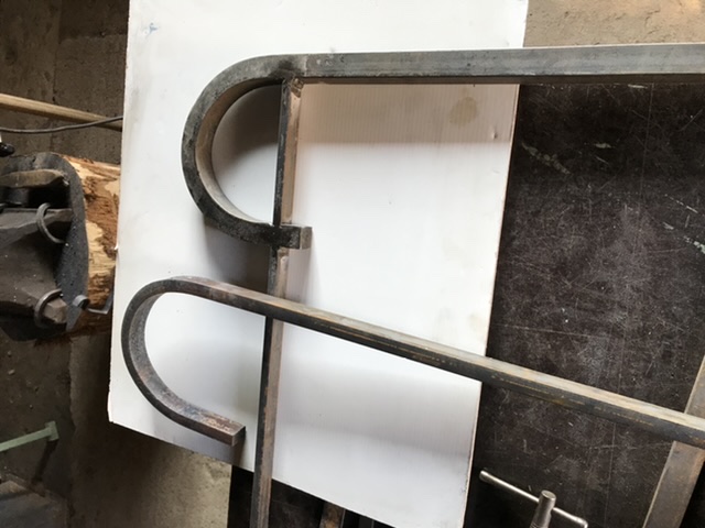

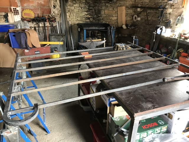

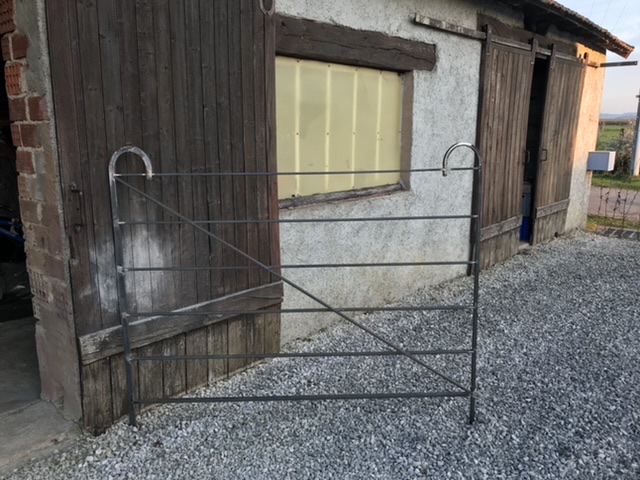

I’m making a pair of gates to close off the front of my yard, and am making them in the same style as the existing ones elsewhere in the garden, horizontal bars and the diagonal are 25mm x 10mm flat bar, hinge end upright is 25mm square, latch side is 25mm x 15mm - they took some forging, maximum blast in the forge for over 20 mins.
