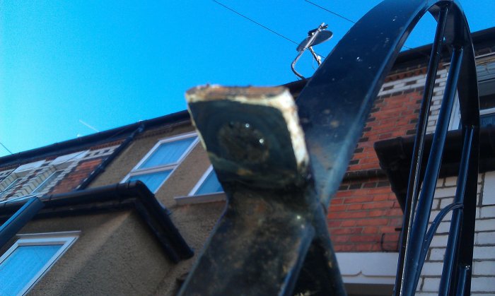

I have been helping a mate to fit some gates and railings. They have been made up from salvaged parts so I have had to cut and weld them to fit them.

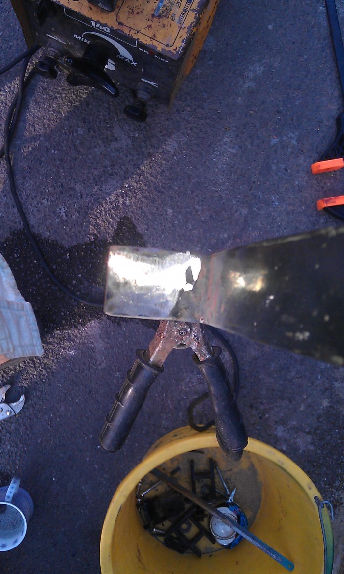

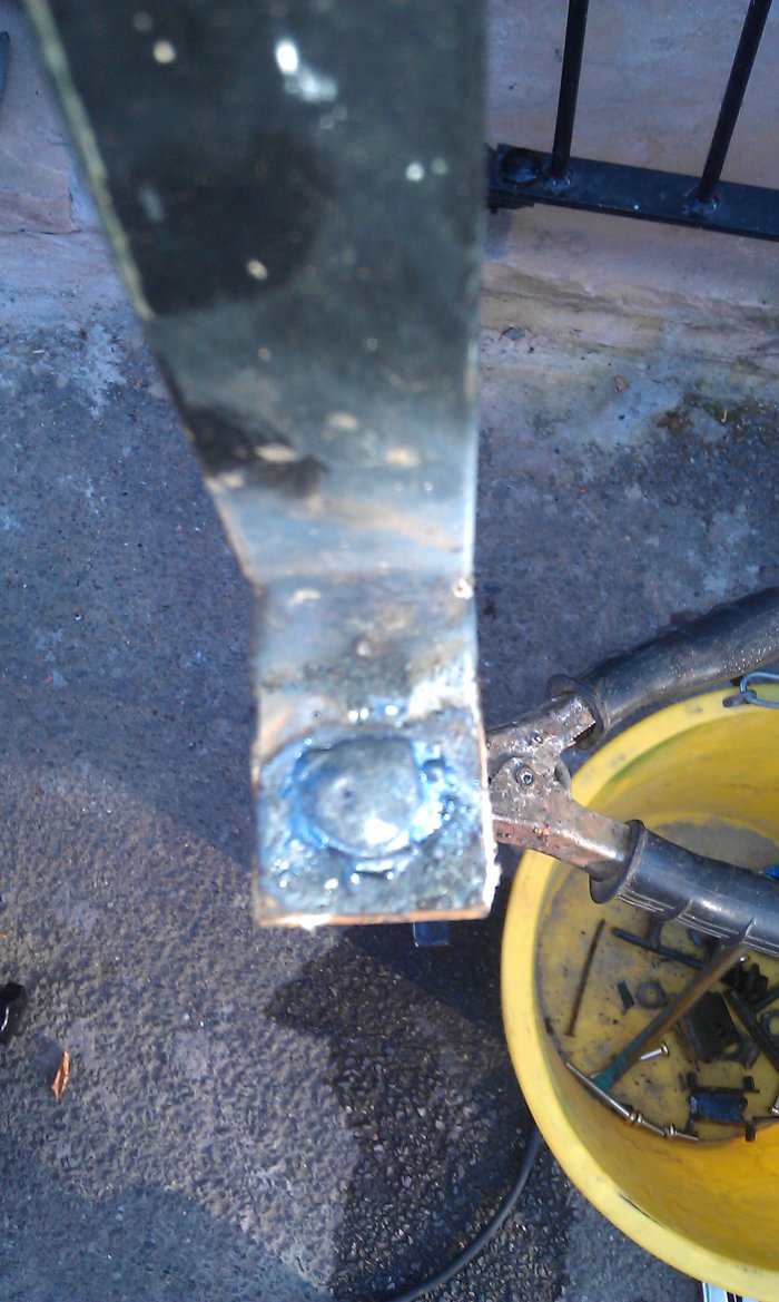

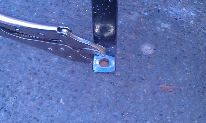

The gates were slightly too wide. I needed to cut and re-weld the hinge hangers, but I thought another method would be worth a try. I decided to fill the holes with weld then re-drill. I used an old 2p coin as a backing and an arc welder.
Only a small project, but I am still very new to this and I am pleased that I learnt something. And I got paid in Pizza for the family
