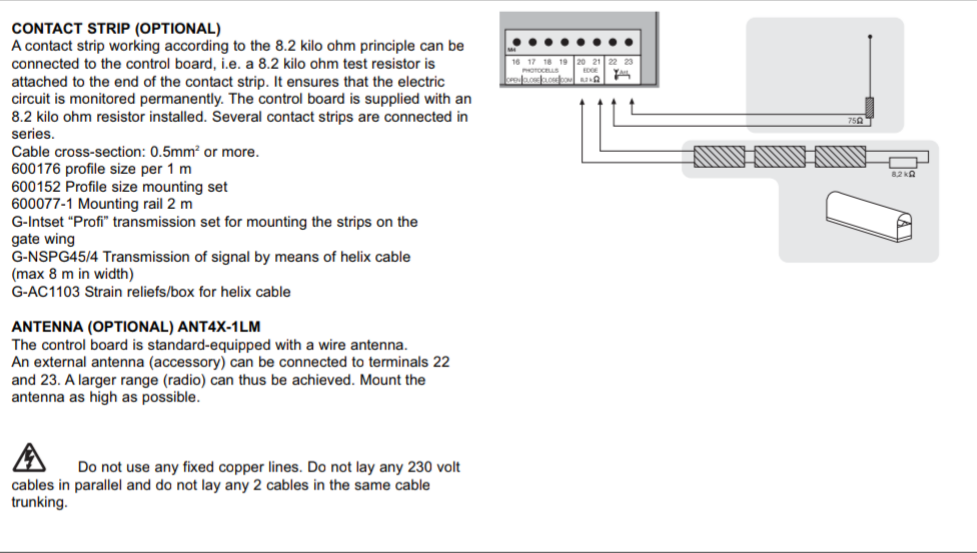

I need to fit a couple of wireless safety edges. Though the concept isn't new to me, actually specifying, buying and fitting them is.
A quick learn tells me there are mechanical contact strips and resistive types. Furthermore you get "end" ones with 1 cable and "through" ones with 2 cables.
On the gate control PCB, across 20-21, is an 8k2 resistor.

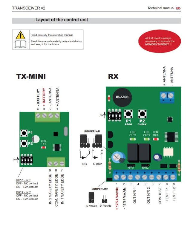

The secondhand, "working when removed" transmitters and receivers I've just bought look like this:

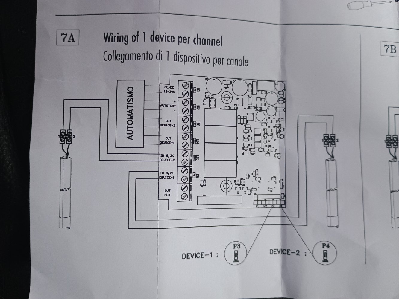

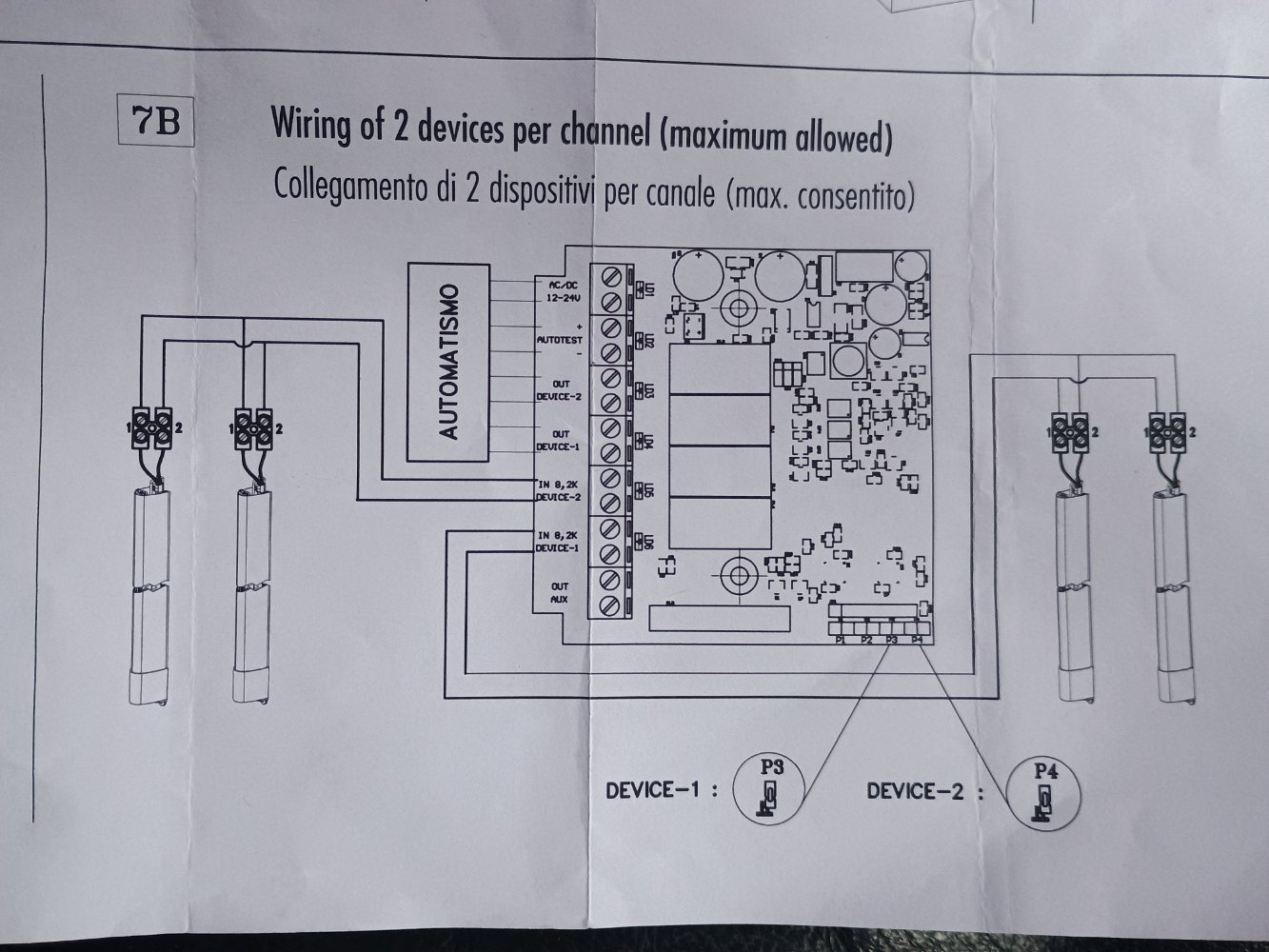

Am I right that I can use mechanical (NC) rather than resistive contact strips and just select which via the DIP switches on the transmitter TX? It appears you could have an NC input on IN 1 and a resistive 8k2 input on IN 2 or vice versa.
Are resistive strips better / safer than mechanical ones?
The receiver RX appears to offer either an NC or 8k2 output. As my gate PCB appears to be expecting an 8k2 input I presume the jumper must be set to that. Furthermore I presume the receiver, set to 8k2 takes the place of the resistor?
I wonder then if I could use mechanical strips to feed the transmitter but have the revceiver set to 8k2?
