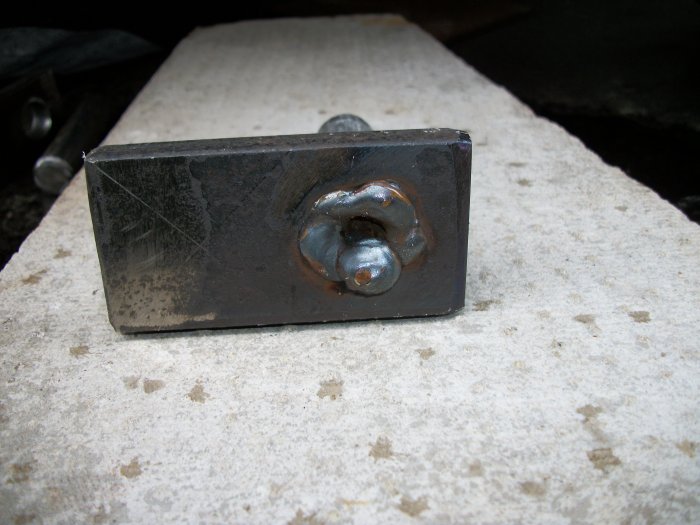

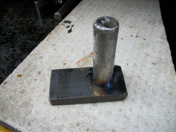

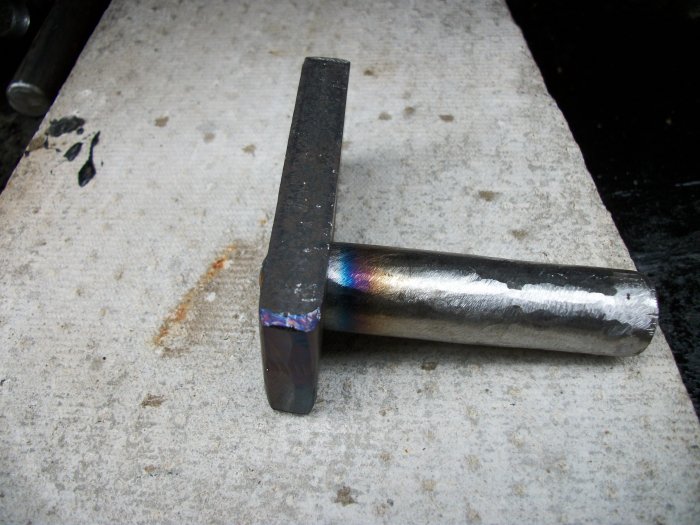

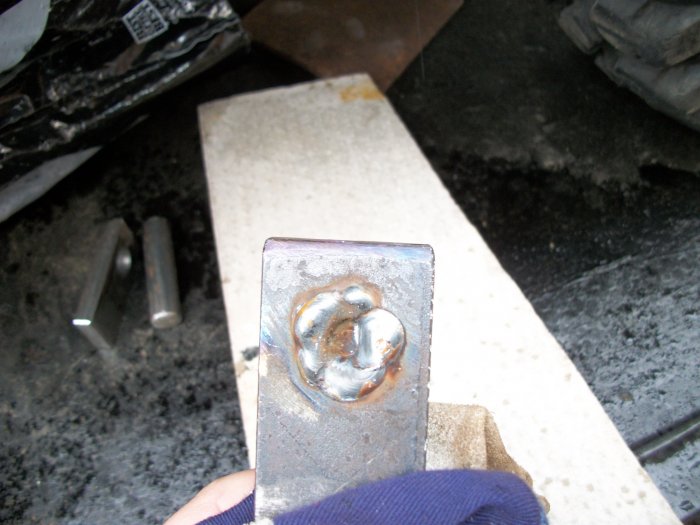

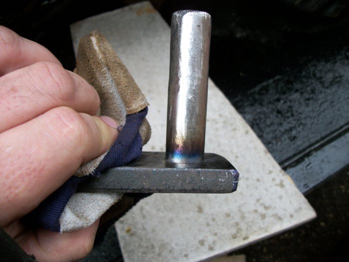

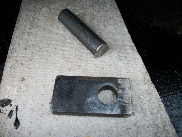

Im posting pics of my gate hinges as promised.
I used argon mix gas set at 10 on dial.
Potamig 185 power set at 2.4
Cleats are 10mm thick.
Dowels are 20mm thick.
I placed the parts to be welded onto an earthed steel plate and used a magnet for the 90 deg angle between the cleat and dowel then welded at the base of the dowel with the dowel inset about 1.5mm into the cleat.
Thanks for all who have helped me get this far.
Mike.
