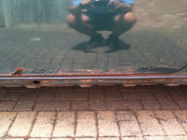

this is the mini before we striped it

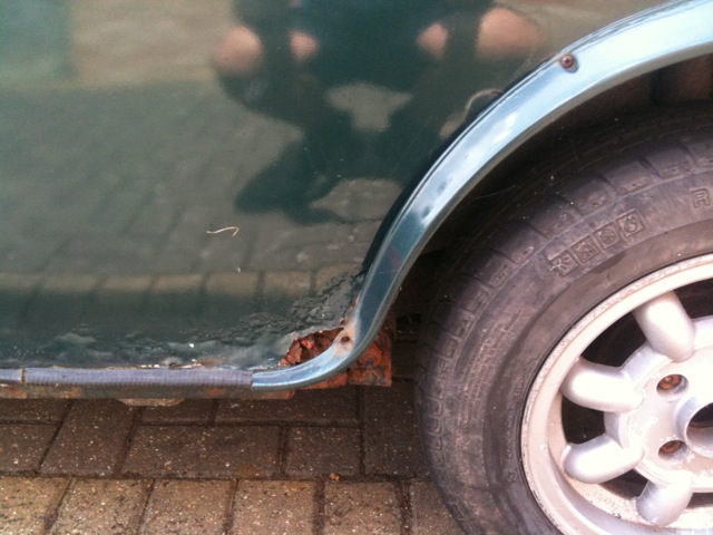

Looks like it's gone in all the usual places then, i'm on my 3rd year of doing mine, shell has only been solid about 6 months (complete new floors, sills, steps, healboard, bootfloor etc etc) and it's still not a rolling shell (although hopefully have that sorted at weekend)

the list of panels for this one is long
n/s
inner/outer sill
door step to rear arch
subframe mount repair panel
boot repair panel
o/s
wing
inner sill (outer only needs a patch but being as i got sills cheap will put one on)
straight door step
patch up at floor/inner sill/wing intersection

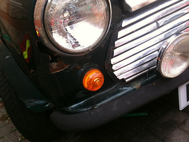

front
scuttle repairs (not sure if to patch or complete panel)
plus any other rust found on the journey
