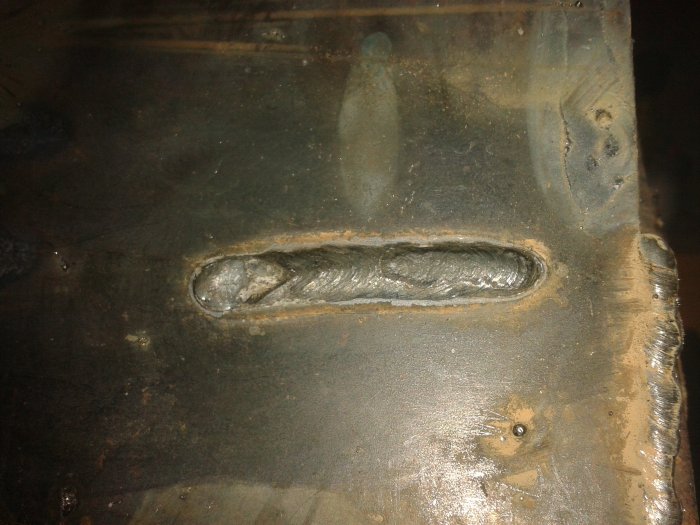

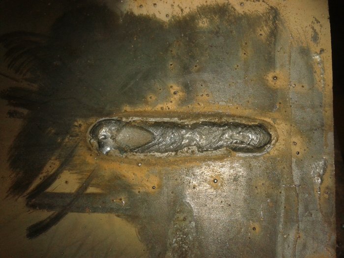

Just put a roll if gasless back in my mig as my mig isnt great with solid wire, but have some co2 gas left so i tried it out.. What a difference! Firstly the nasty smoke that normally stops you from seeing is virtually not there, also the puddle looks wetter pretty much like a solid wire puddle, and you can push or pull the torch without trapping the slag. The slag just flakes off when done. This was done with cheap Sip wire. Will post a couple of pictures later on. Now, is this big improvement due to the fact that the atmosphere cant get to the flux to cause a reaction?
