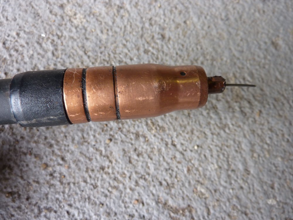

The Gys was not set up for gasless so polarity was changed -easy job.
The Gys gasless kit was purchased-part no 041240-this consists of:
http://www.hd-outillage.com/soudage-sans-pour-fourre-p-2407.html the shroud is cut right back and the tips (1mm were supplied not 0.9) stick out from the shroud.
It worked well and I had no problems seeing where I was welding which I understand can be a problem with fluxcore.

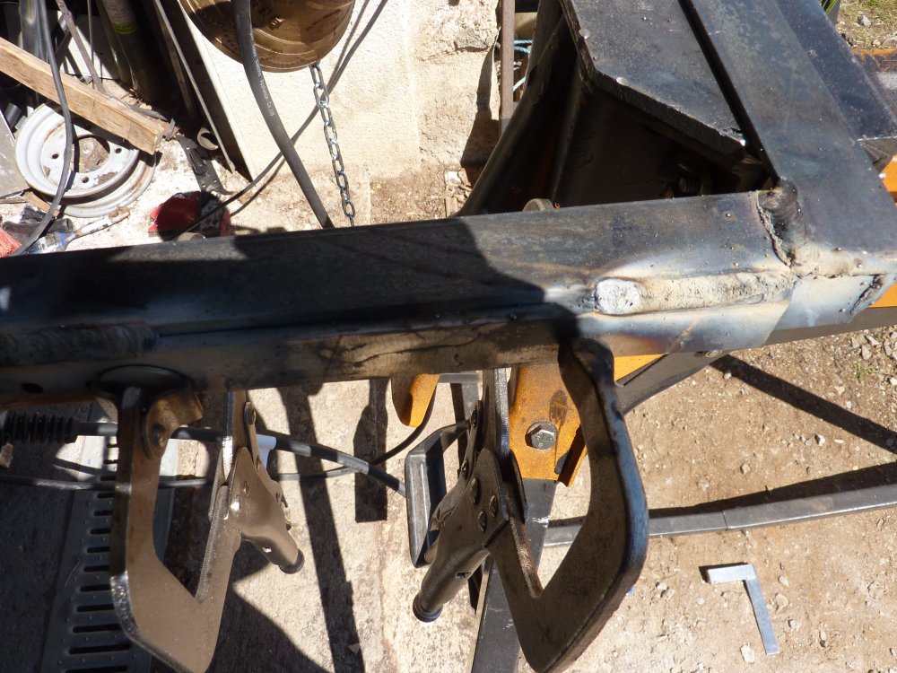

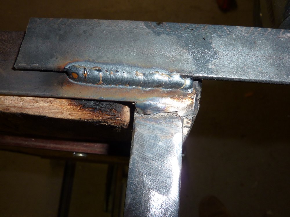

The welds were way better than my previous efforts and when the settings are right they resemble stick welds-not as pretty as stick (I'm not too bad at stick as I did two years of an apprenticeship in steelfab).
Spatter was nowhere near as bad as before, I did use anti spatter for some jobs to protect clamps etc but it was nothing like the problems I had some years ago.

Clean up was pretty easy-hand wire brush, wire cup on angle grinder does a top job as you would expect.
Pretty happy with gasless mig, I pulsed on some thin stuff 0.8 I think it was and it went pretty well.
