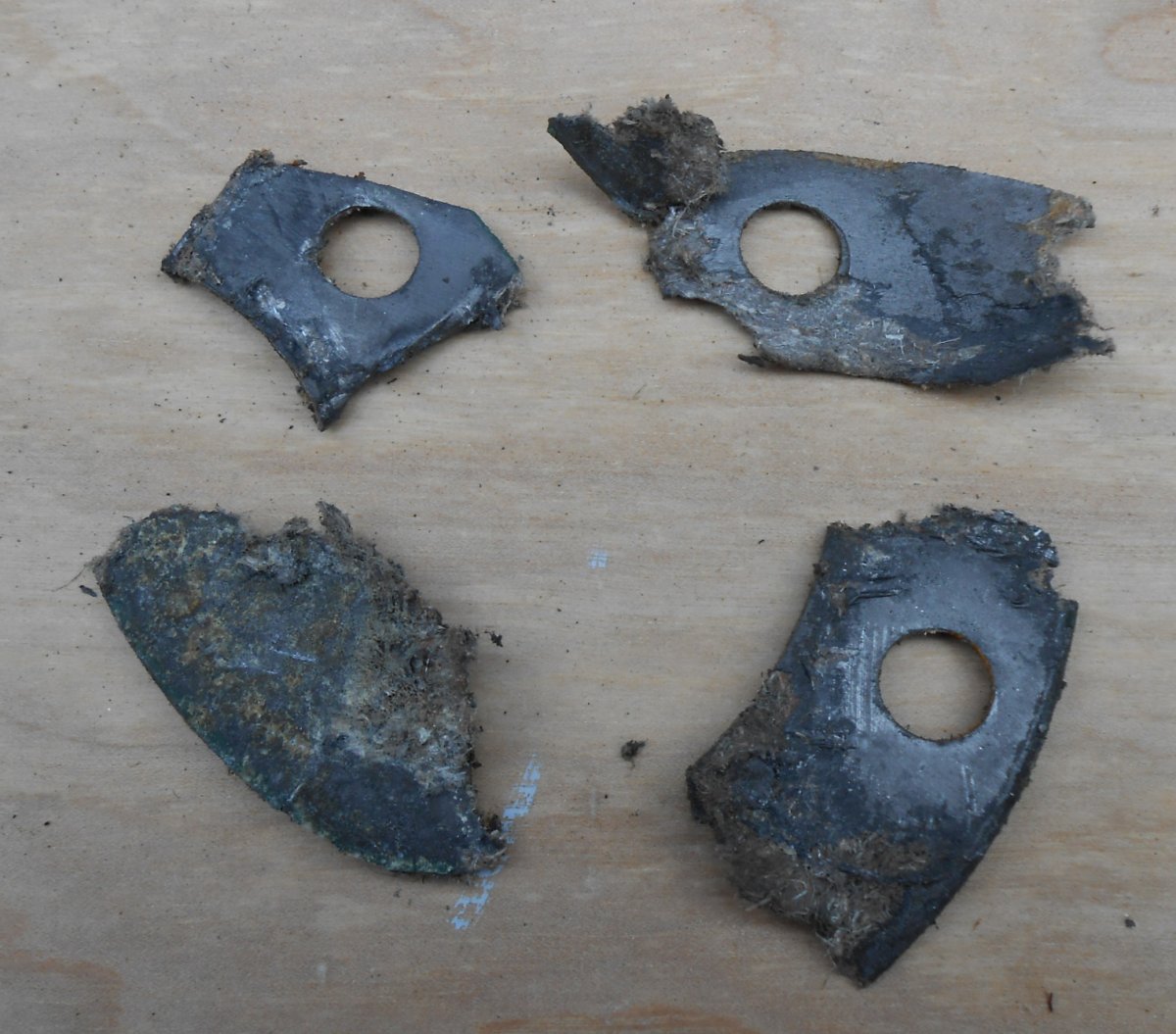

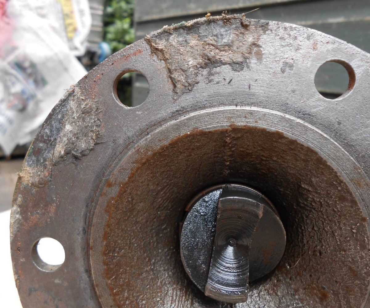

Brad93 Member Messages 19,085 Location Essex, United Kingdom Nov 28, 2019 #41 That’s CAF. Be very careful. Compressed asbestos fibre. With a graphite foil. Makes a great seal. You can get CNAF gasket now.

mtt.tr Member Messages 8,456 Location Essex/Suffolk border Nov 28, 2019 #42 Brad93 said: That’s CAF. Be very careful. Compressed asbestos fibre. With a graphite foil. Makes a great seal. You can get CNAF gasket now. Click to expand... Dad still has a roll of it from the 60-70s, keep telling him to get rid of it.

Ali Member Messages 1,901 Location Cheshire Nov 28, 2019 #44 mtt.tr said: Dad still has a roll of it from the 60-70s, keep telling him to get rid of it. Click to expand... Me too, wondered what that was made of...thanks
