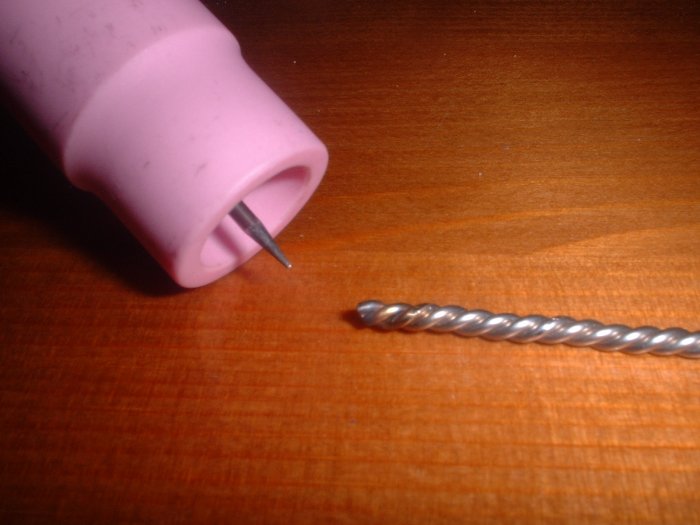

Hi all, ran out of tig rods at work middle of a job and have only gas welding rods until monday morning, Can you use both and what are the implications of using the gas rods?

gas rods will not work well as there is no deoxidizers. Usually causes porosity.
Ahh! that's clever! Will teh gas welding rods just give a grey oxidised look then?
We used gas rods for learning tig at my local college. Maybe that's why I found it harder tiging steel than aluminium.
I find this hard to believe, how did you know rods were for O&A process?
Would this be a budget thing?
