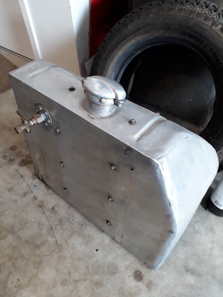

they were sweet , like a Bonnie tank shape with manx norton knee dents ,, and a sachs engine , oh they really were sweet.Mate of mine used to gas weld fuel tanks for Dalesman motorcycles, very, very neat. Try as hard as I could I never mastered it

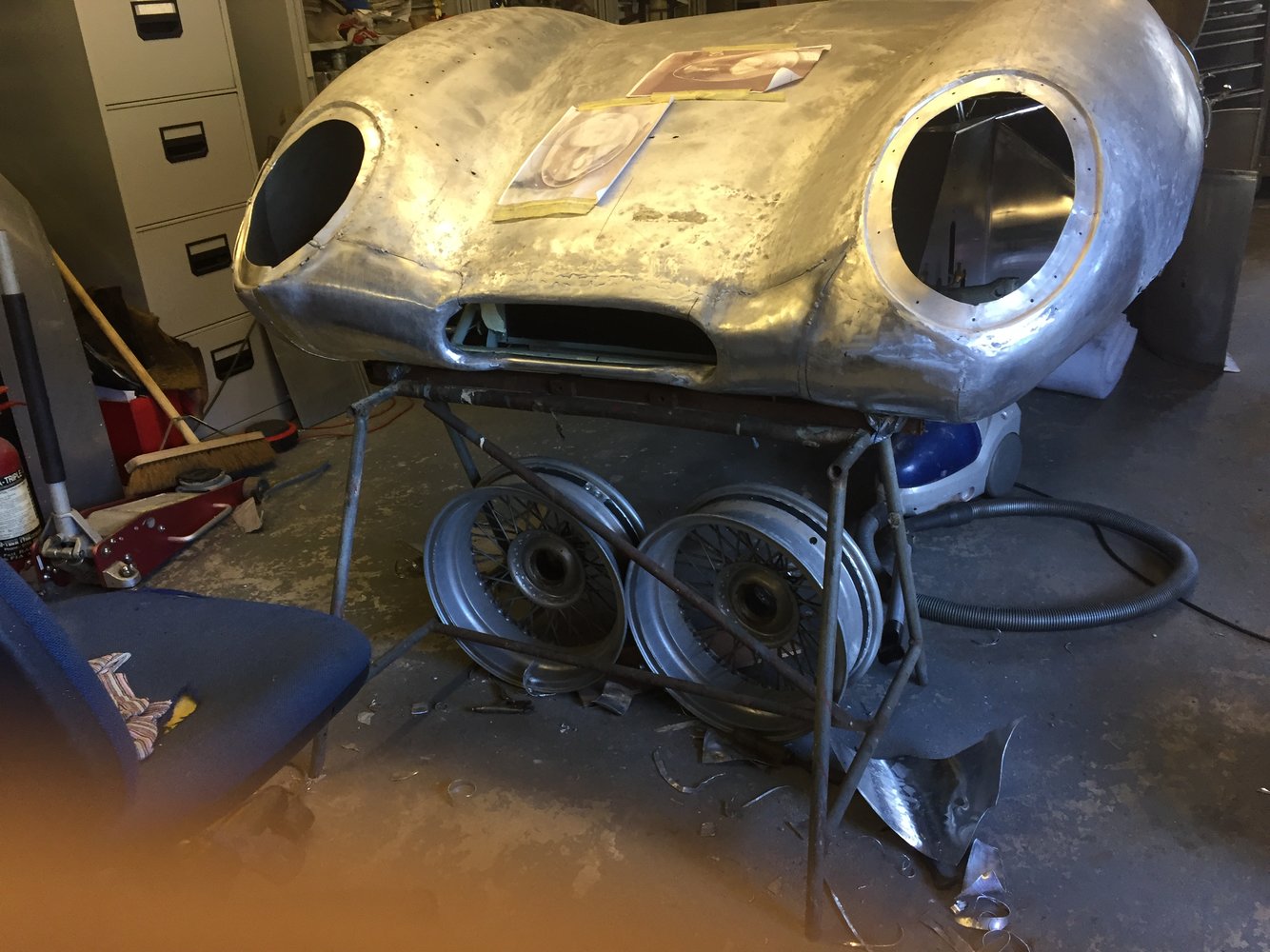

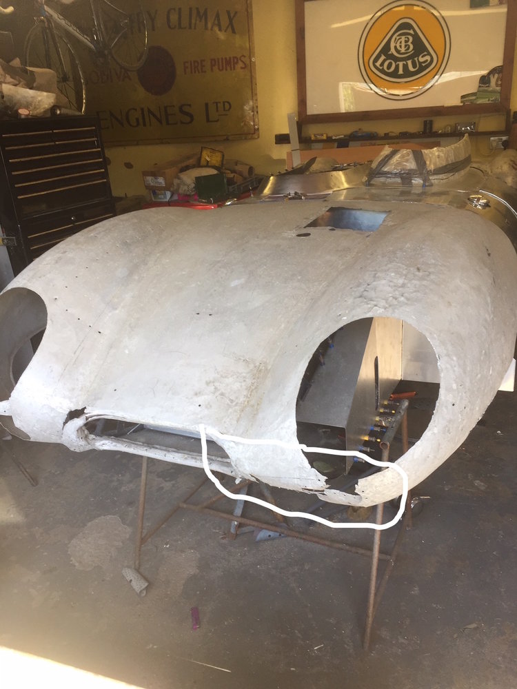

Dell thanks i am not doing bad my welds are withstanding hammering some are a little bloby lol when the old ali runs away from me i have learnt an awful lot and turned the gas pressure down to a min. The hardest bit is starting the weld once i start the run its ok as long as i keep an eye on the heat as with all welding i suppose this morning i had to weld some 16 gauge new ali a walk in the park compared to the old 20 gauge and quite neat. I do love a challengeHi Andy
I have just seen your post because until yesterday I hadn’t been on forum for a while, I have been gas welding aluminium for about 50 years on and of .
When I weld new to old I use a strip and clean wheel on the old on both sides if possible to try and get as much contamination out as possible, I cut narrow strips of what ever I am welding ( I never use rods ), a lot of people advocate fluxing work but all I do is dip aluminium strip in flux powder ( but not in the pot as it’s hygroscopic) tip some in another container and never put back, bias the torch towards the new material unless it is small as it takes longer to heat than the old, wash flux off with boiling water ( BUT DO NOT BREATH VAPOUR ) as it is corrosive.
Hope this helps Dell

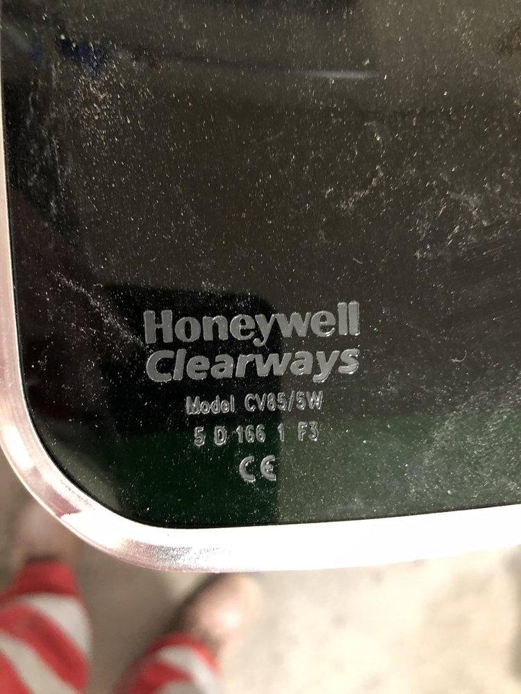

PS I will try not to forget to look at visor
yep got one as advised by you works well
