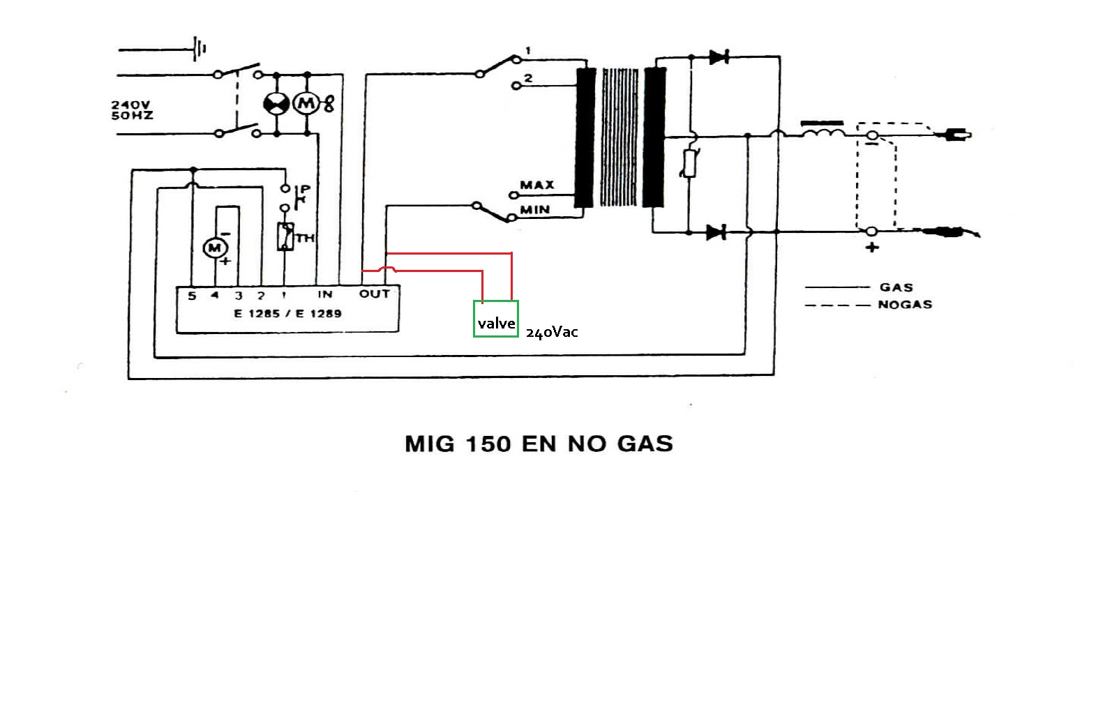

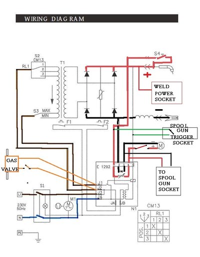

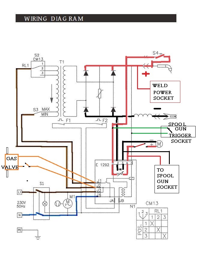

If your pcb has the same number as in this pic then you should be able to add a 240Vac valve shown as the red lines and green box. Note any connections will need to be sleeved type as you are dealing with mains.Does the same apply for the 151EN ?
Anyone have an idea where the connections are within the welder physically?
