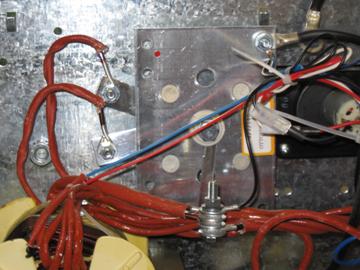

Hi, I'm new to MIG welding and have got hold of a Wolf 135 Turbo Mig Machine with a dodgy gun. I've bought a good quality universal replacement gun, but found that there was no gas valve in the torch like the original. I've now bought a gas solenoid valve and installed it 'mechanically' into the machine. The coil on the solenoid valve is marked as 48v AC. Now here is the problem, where do I get 48v AC from in this machine? Will this coil also work on 24v DC?. I do not have any fitting instructions for the solenoid valve or wiring diagram for the MIG welder itself, does anyone know where I can get these from? Great forum by the way........
