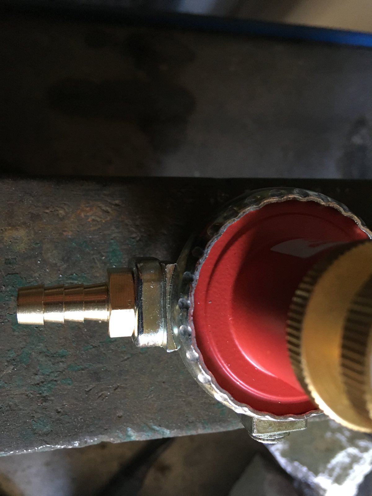

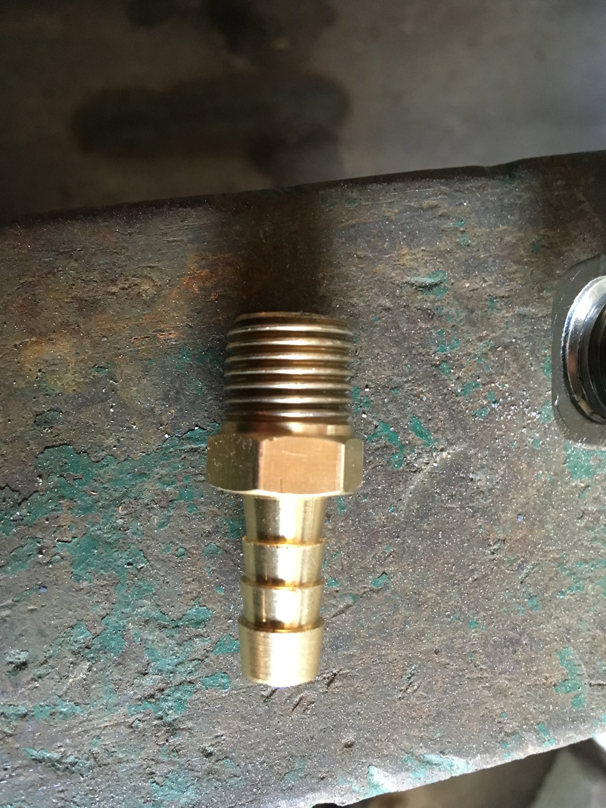

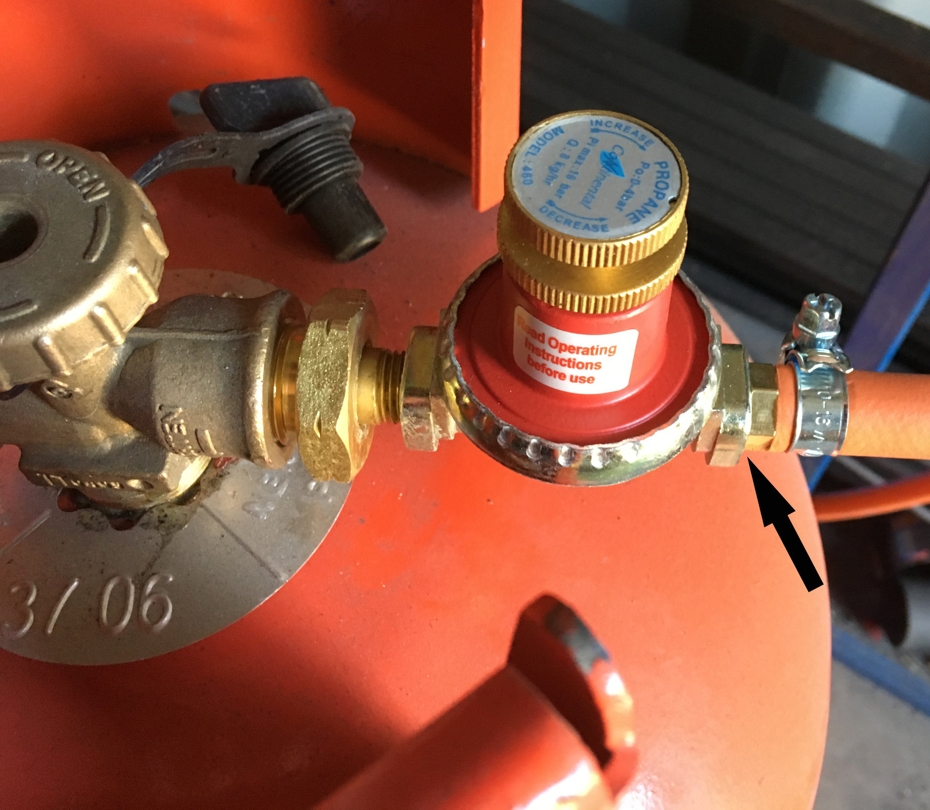

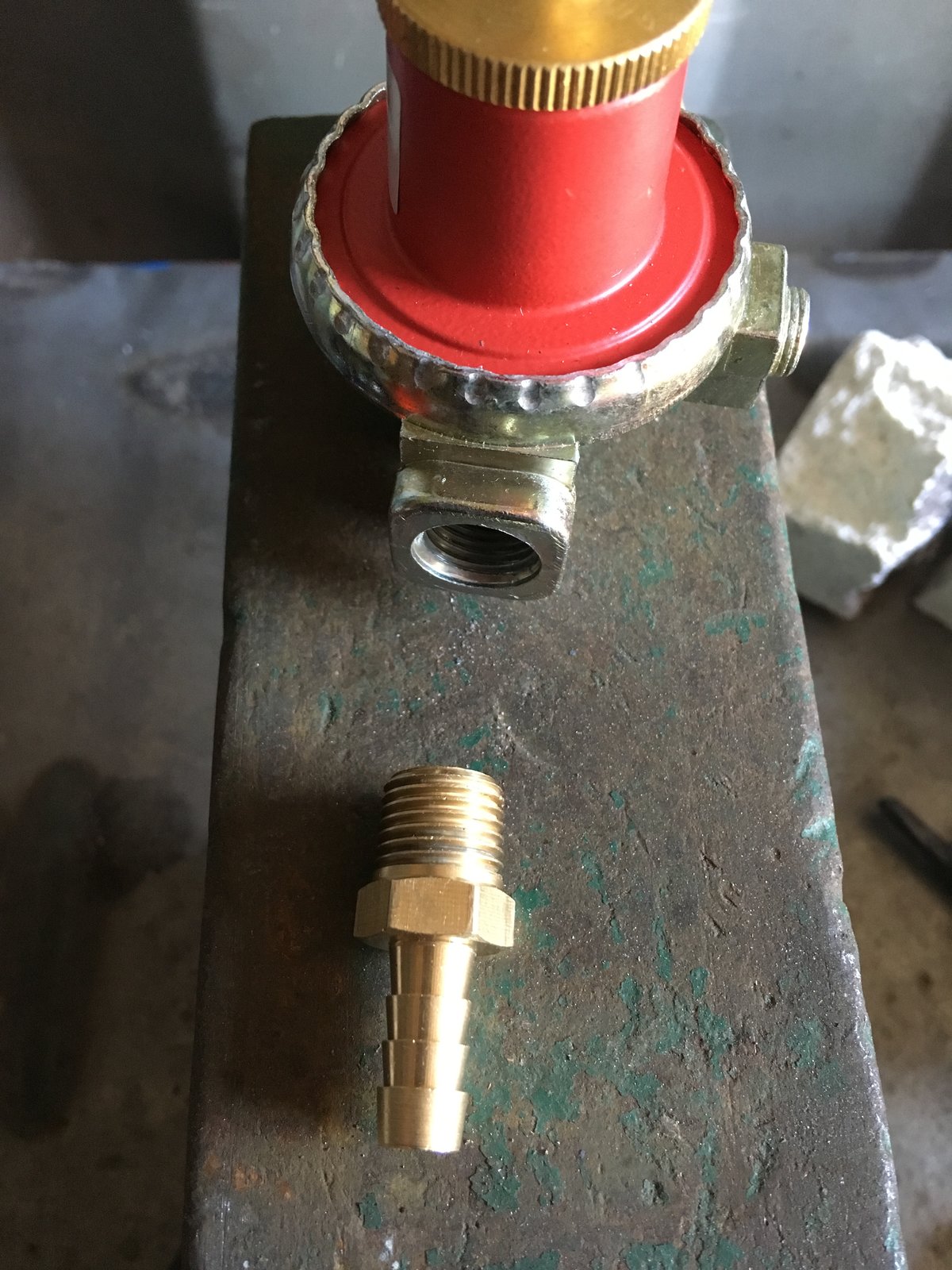

if the bullnose is slightly damaged or leaks what you can do is take any rough bits off with emery cloth put it on and slightly tighten it not too much though get some grips on the tail and turn it round a couple of times . it makes a better seat and takes any rough edge off . then tighten it up and check for leaks not all the bottles you get are in good condition as should be
