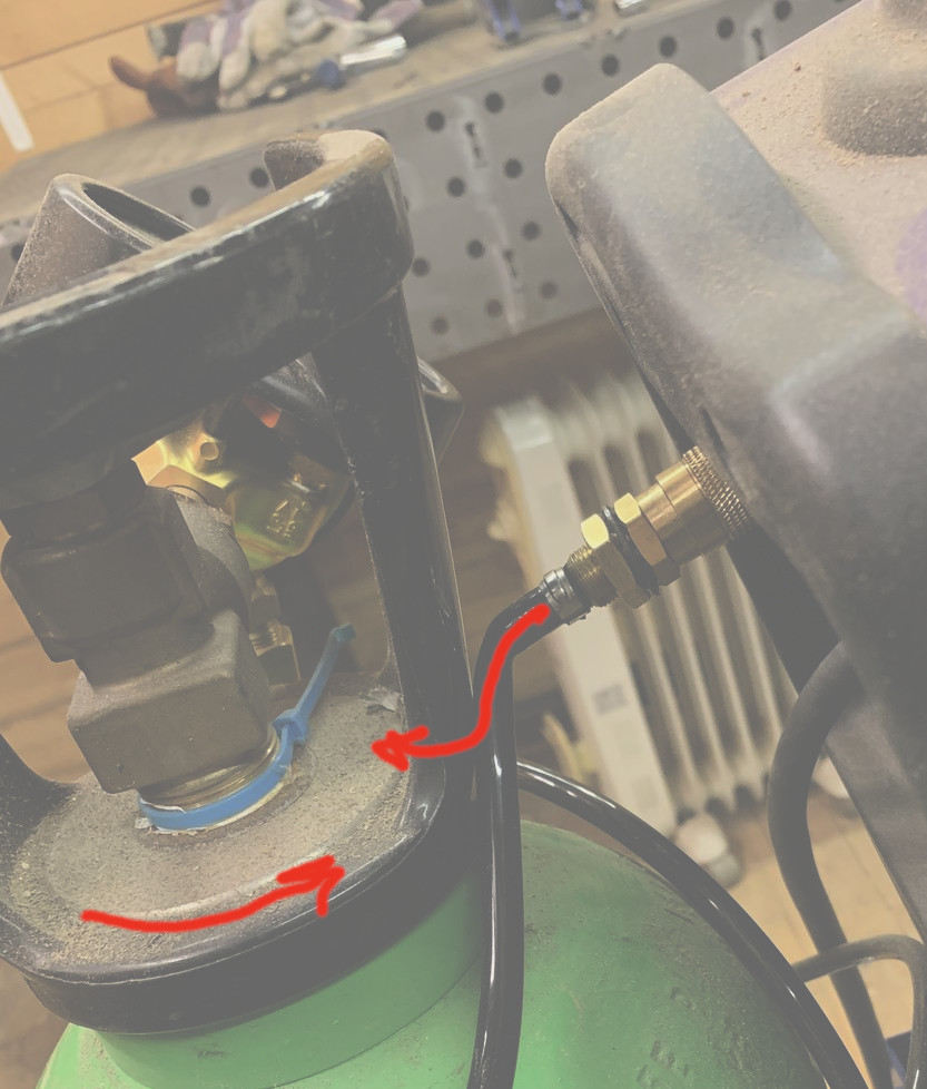

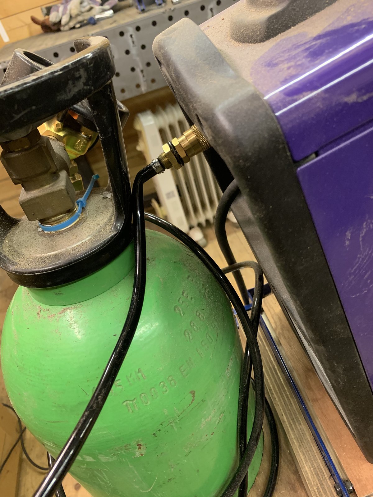

I’ll have a look , might be tight thoughRotate the bottle a tad and the coupling looks like it would go past the valve guard.
Bob

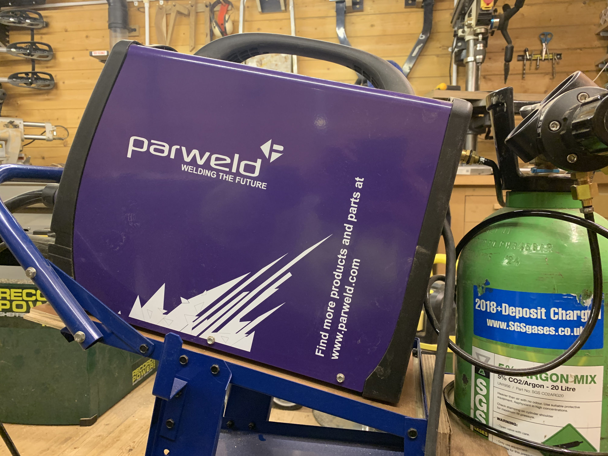

Yes that might work. Don’t know why it is so steep an angle, I only put it together a couple of days ago it’s ok but I probably should of made oneDoes the angle of the top shelf need to be so steep ? undo the four bolts pivot the shelf down a little and re drill the holes
= more clearance at the back of the machine just a thought

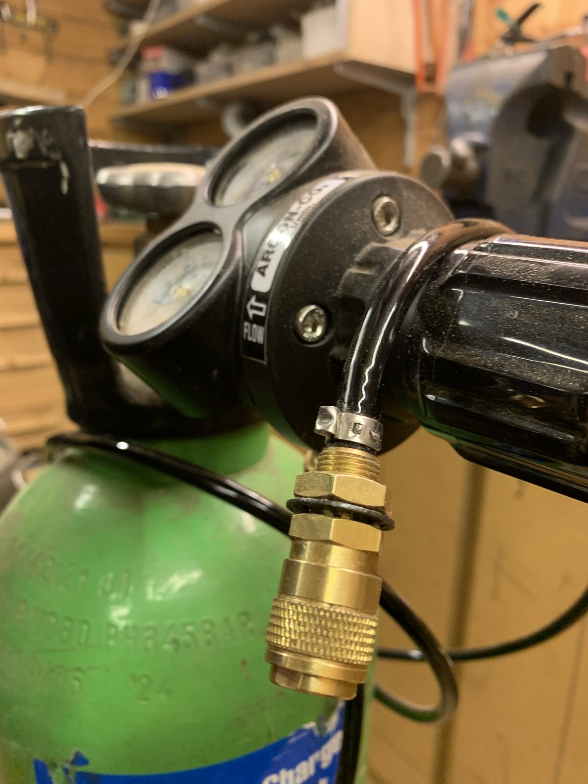

Think your right , looks the same to me. Now I know what they’re called I’ve got a better chance of finding one. ThanksLooks similar to a rectus 21 type fitting. Maybe an elbow like one of these...
https://www.keeconnections.co.uk/90-degrees-050-series.php
Yes I’ll have a look tomorrow, it’s cold out now ,and I’ve got my feet up in front of the TellyBefore buying anything though, as @8ob said...
..maybe try that. I could see that working perhaps?
