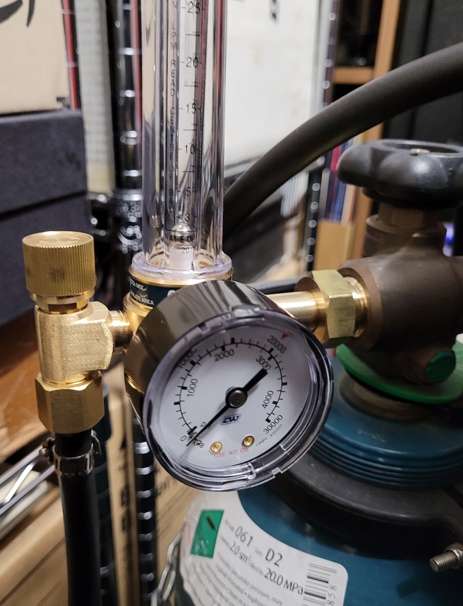

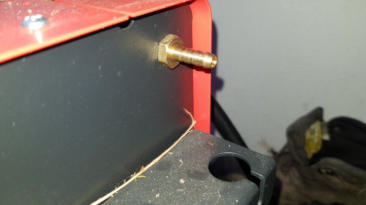

Hi all Im pretty new to welding and not sure how Ive ended up like this but I have a sealey supermig 150 which has a small gas outlet at the back of the machine but the regulator I have has a larger fitting. They look the same, its just larger in size. The gas line that came with the welder is pretty basic but i sqeezed it onto the regulator so its super tight on that end but on the welder end its not snug and leaks even with the tiny clip fitted.
Ideally I would like the welder to have a bigger outlet so it matches the regulator, can I do this? Does it just unscrew (see pic)? I could then buy a bigger, more decent hose that fits well at both ends.
In an ideal world I would have some sort of quick connect fittings each end if they exist? As I leave the gas outside and mig goes inside.
