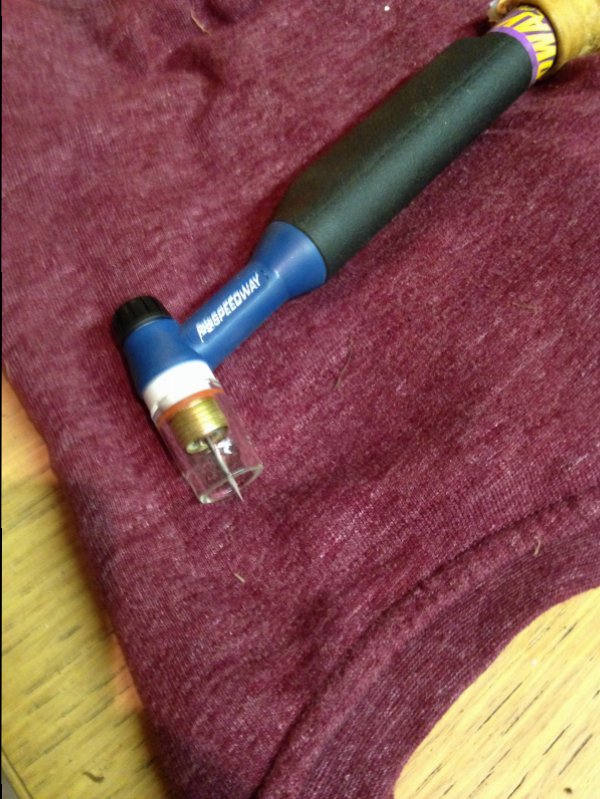

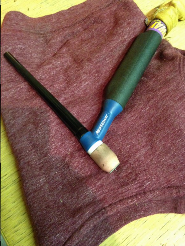

My thoughts exactly.When u say largest.
Are we talking it's body size or its electrode size
... the CK stuff mentioned that uses push fit cups on their specific collet bodies
Gotcha. That's a CK branded version of the weldcraft style large gas lens. Everyone does them (although the cheapnese versions are often properly nasty quality) hence me assuming it was their gas saver typeI didnt mean the gas saver units, they do a regular lens with larger body too for the 9 and 20 torch
thanks everyone for replys on gas lens sizes very helpful off to do some shopping now better not tell the wife though she thinks decorating more important3,2 mm or 1/8" is the largest I've seen too.
At least CK makes a large version gas lens for bigger cups. Dont know if it is the same size (1" ?) as the larger lens for a 17 torch head though.
