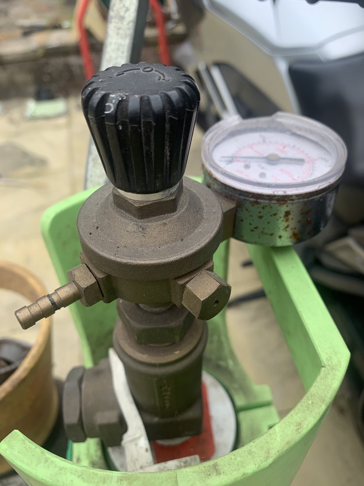

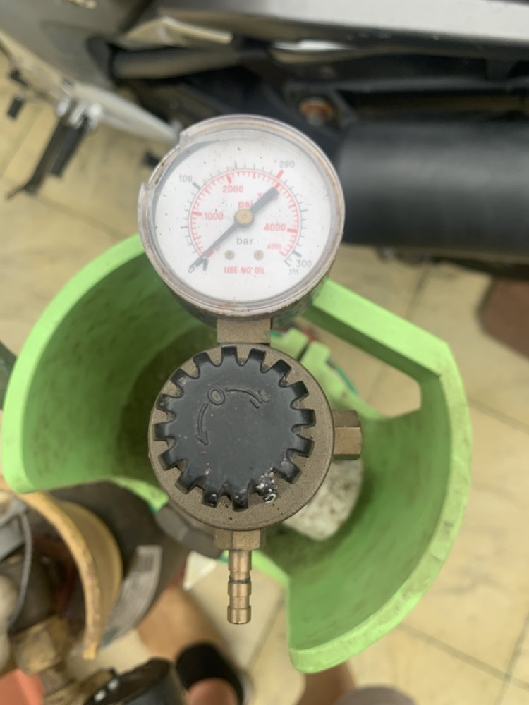

Hi guys I tried to do some welding yesterday, but when I turned the gas on it was leaking from the brass nut with the hole. Does anyone no what's wrong? is it knackered?
Never had any luck with those cheap regulators, mine gave you a burst of gas then not enough to cover the weld. Invest in a twin gauge single stage, you'll get one from ebay for around £20. What pressure is in your cylinder it may be too high for the reg rating.
